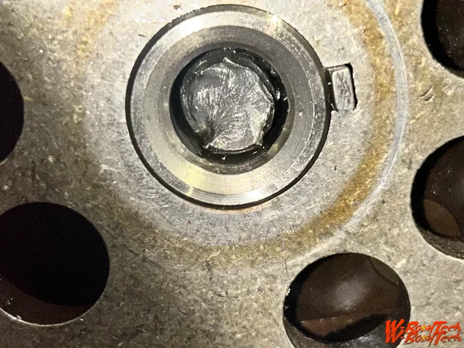

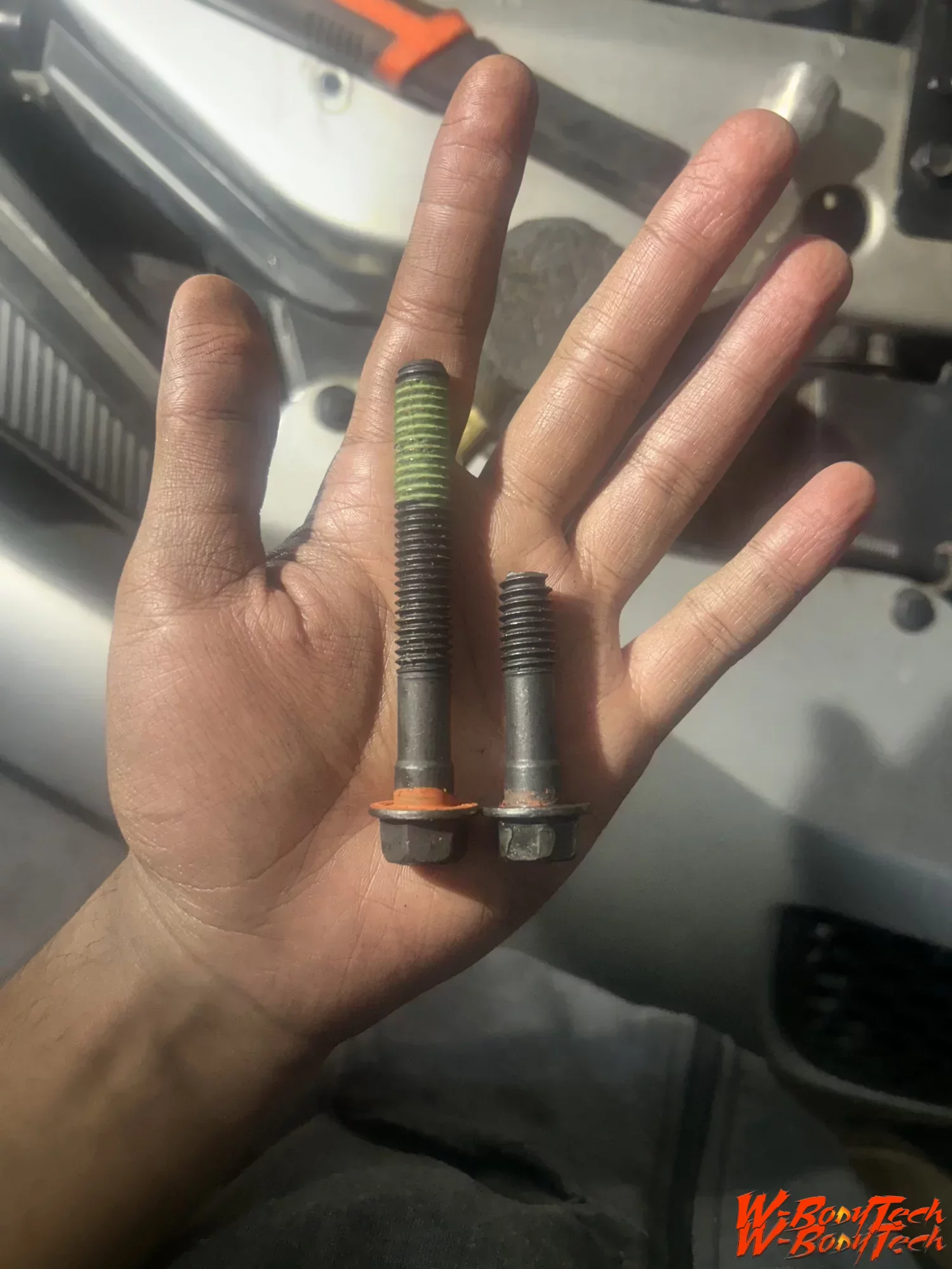

TTY cam bolts should be replaced. I did not replace it. Expected consequences arrived.
Woe. Is. Me.
Build is henceforth paused until I have more money for a new cam.
Fuck consequences. Here at WBT we get shit done. Peep them stretched threads, that's that good TTY shit.
Everyone else use this as a learning moment. NEVER reuse TTY bolts, no matter how many other forums tell you it's safe. Shell out the $10-20 for new hardware, save yourself the headache.

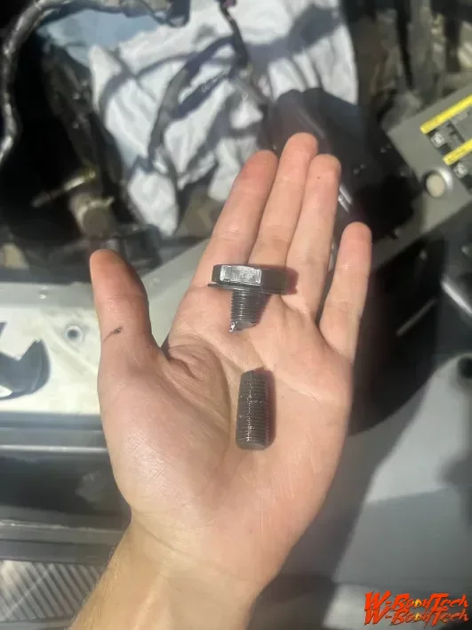

At long last, after an entire year of slowly working towards this project, the mechanical aspect has finally come to a close. Getting that broken head bolt out was a massive pain in the ass, but with some magic and luck it worked its way right out.
I would like to STRESS the importance of either buying torque wrenches new, or at the very least using one that's verified good. Skip out on any rentals ESPECIALLY one rented from a certain autoparts store. *cough cough, AUTOZONE, cough cough*

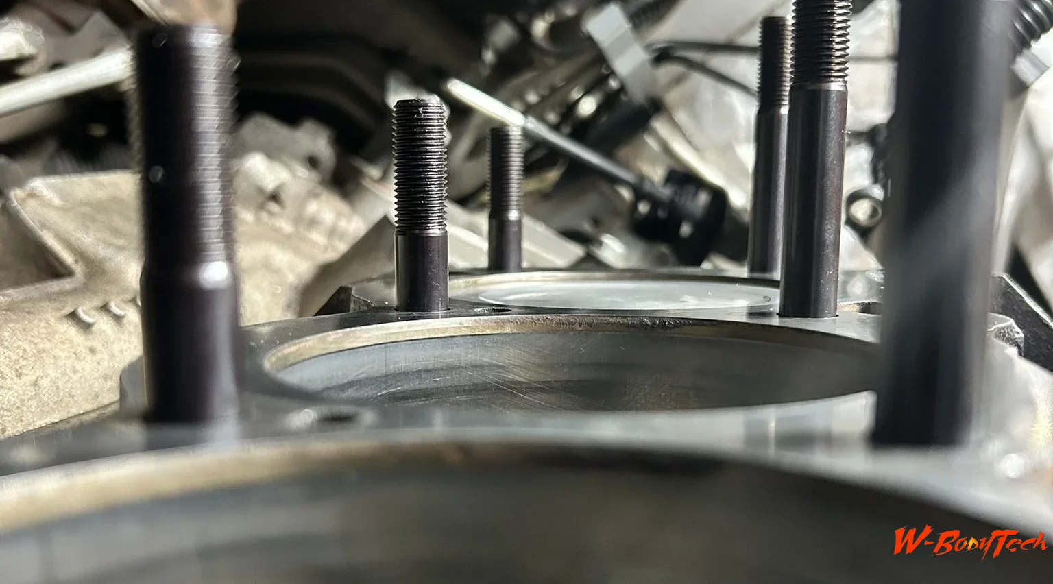

Deciding that money is no longer of any object I decided to forego TTY silliness and ball out on some of ZZP's re-usable head studs. From the way they were packaged, to the weight of them in hand they felt like serious pieces of hardware. Quickly note that ZZP recommends thouroughly cleaning and chasing the bolt holes and added 4-5 wraps teflon tape as the bolt holes go into coolant jackets. Graphite gaskets (as recommended by WBT) were used here bc I didn't feel like shelling out for MLS.

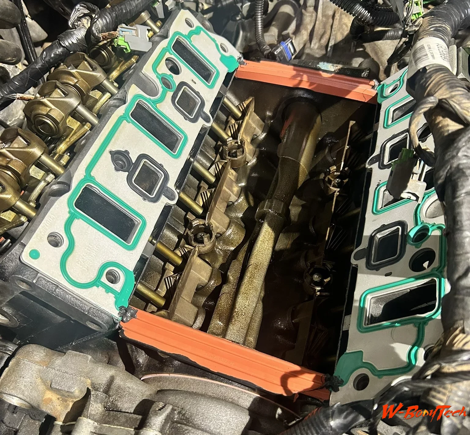

Followed up with the (as recommended by WBT) ALUMINUM lower intake gaskets and generous dabs of RTV in each corner. Plastic ones are known to go bad, and RTV helps to seal the corners. Decided to up torque to 15ft/lbs with the aluminum gaskets. ZZP's reuseable rocker bolts, while not well-pictured, are used as well. IIRC 23ft/lbs and red loctite.

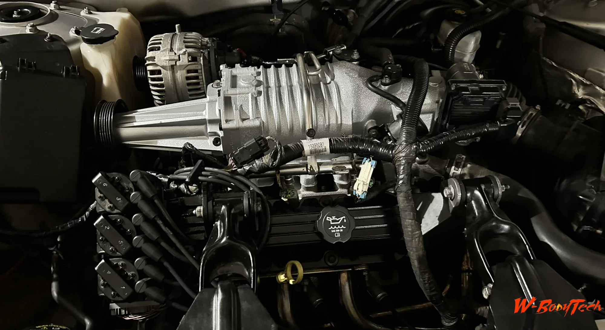

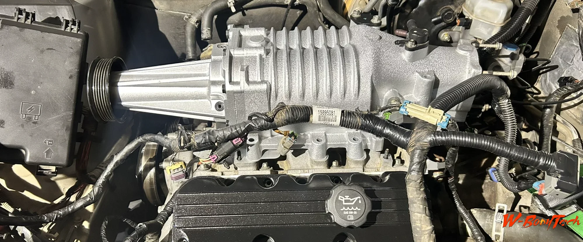

A well-cleaned LIM and freshly painted supercharger complete our yummy 3800 sandwhich. Again, (as recommended by WBT) aluminum SC gaskets are used.

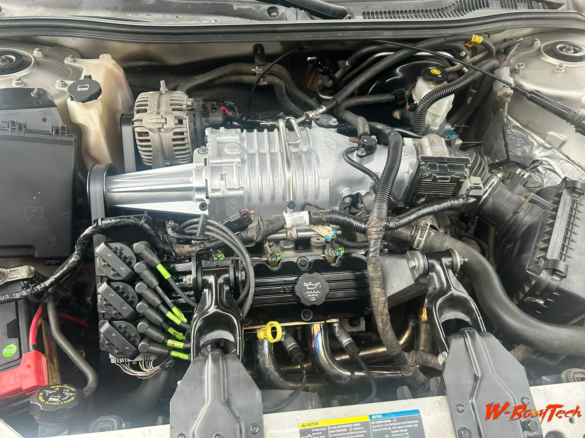

Finishing up the other stuff, SC harmonic balancer, idler pulleys, tensioner pulley, and dogbone bracket/ICM bracket are all added. Boost bypass solenoid is removed due to not having the connector for it, and since my NA harness only has one connector for a MAP sensor I've got a short run of rubber tubing connecting the SC one to the little connector on the LIM. I'm assuming some wiring stuff and vacuum stuff here is probably wrong, so I'll sort that all out as we go!

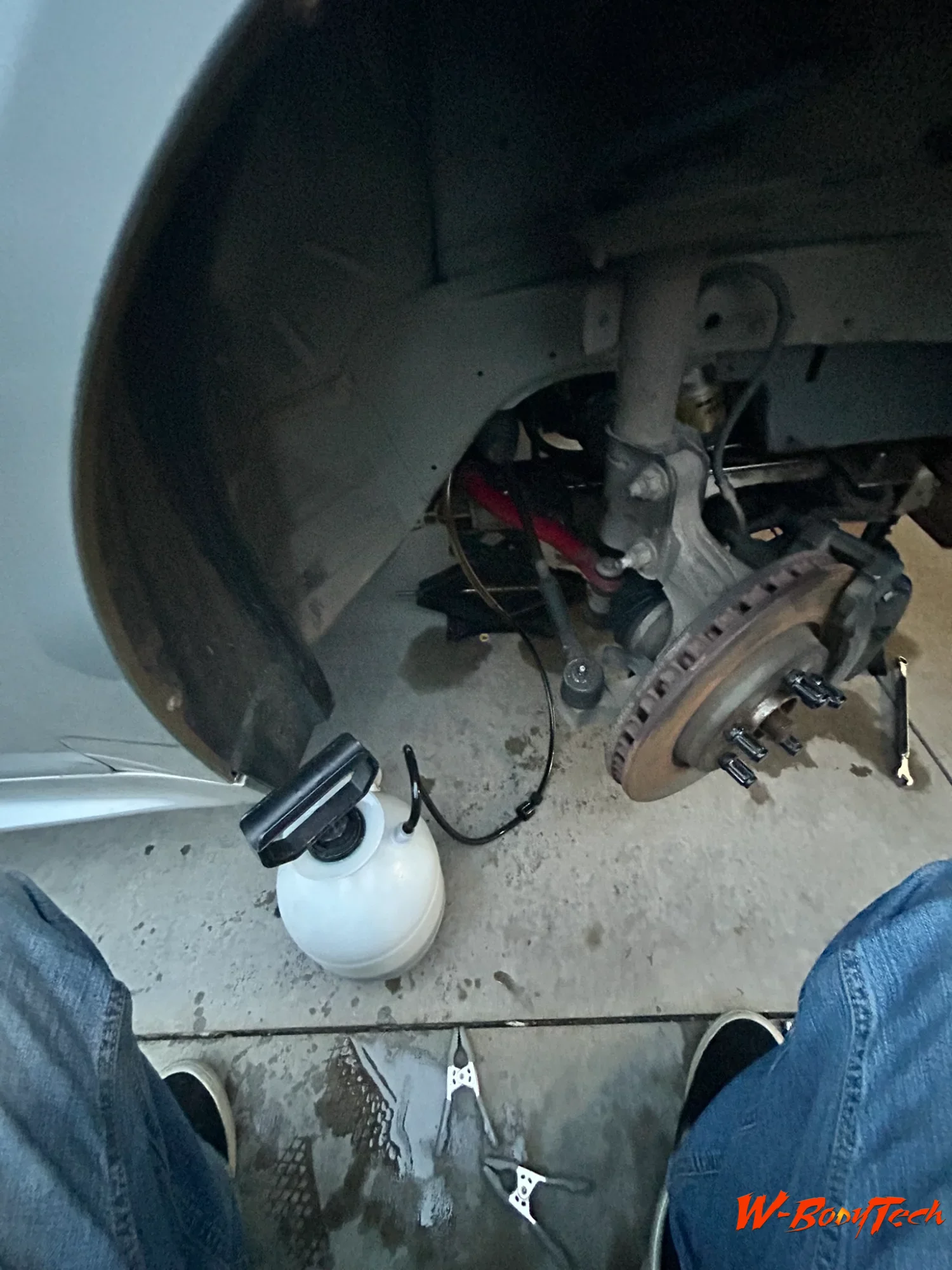

Learned that oil pump loses prime when removed. Oil filter housing also puked out all its oil, further losing it prime. I'm told pump can be primed again by forcing oil up the filter housing, so I'll be off on a little adventure tomorrow after work to find everything I need. Guess I ran out of Christmas magic here.
Did you get the oil pressure sorted out?

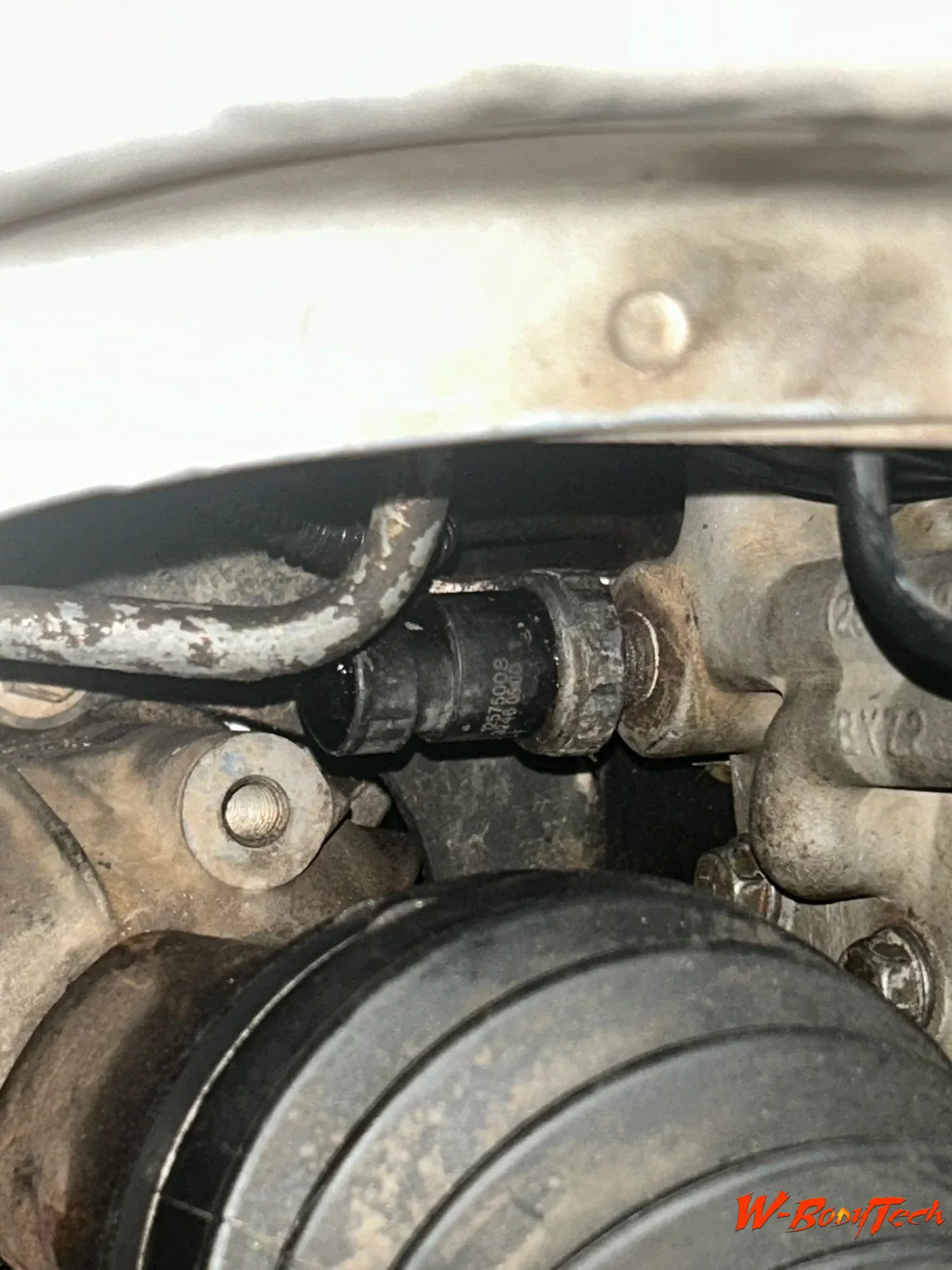

I believe so. Used the setup pictured below to force oil up through the oil pressure sensor. Just a barb fitting with the same thread, some clear hosing, and one of those pump sprayers w the wand.
With that sorted, I'm running into a different issue. No matter how much throttle I give it the car doesn't want to start at all. I've verified fuel pressure at rail as well as spark, so I'm running into a loss here. HPT isn't showing any codes either, which is very very odd. Next thing to verify is that my fuel injectors are all good, so its time for me to look for some wires and a battery to test them with.

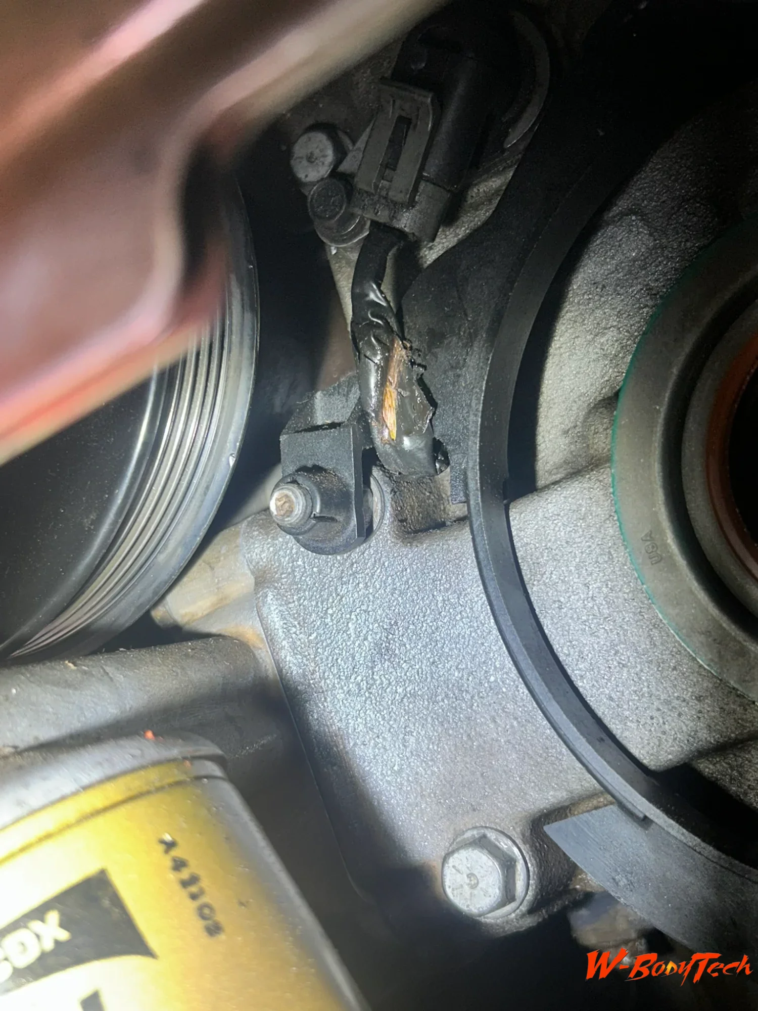

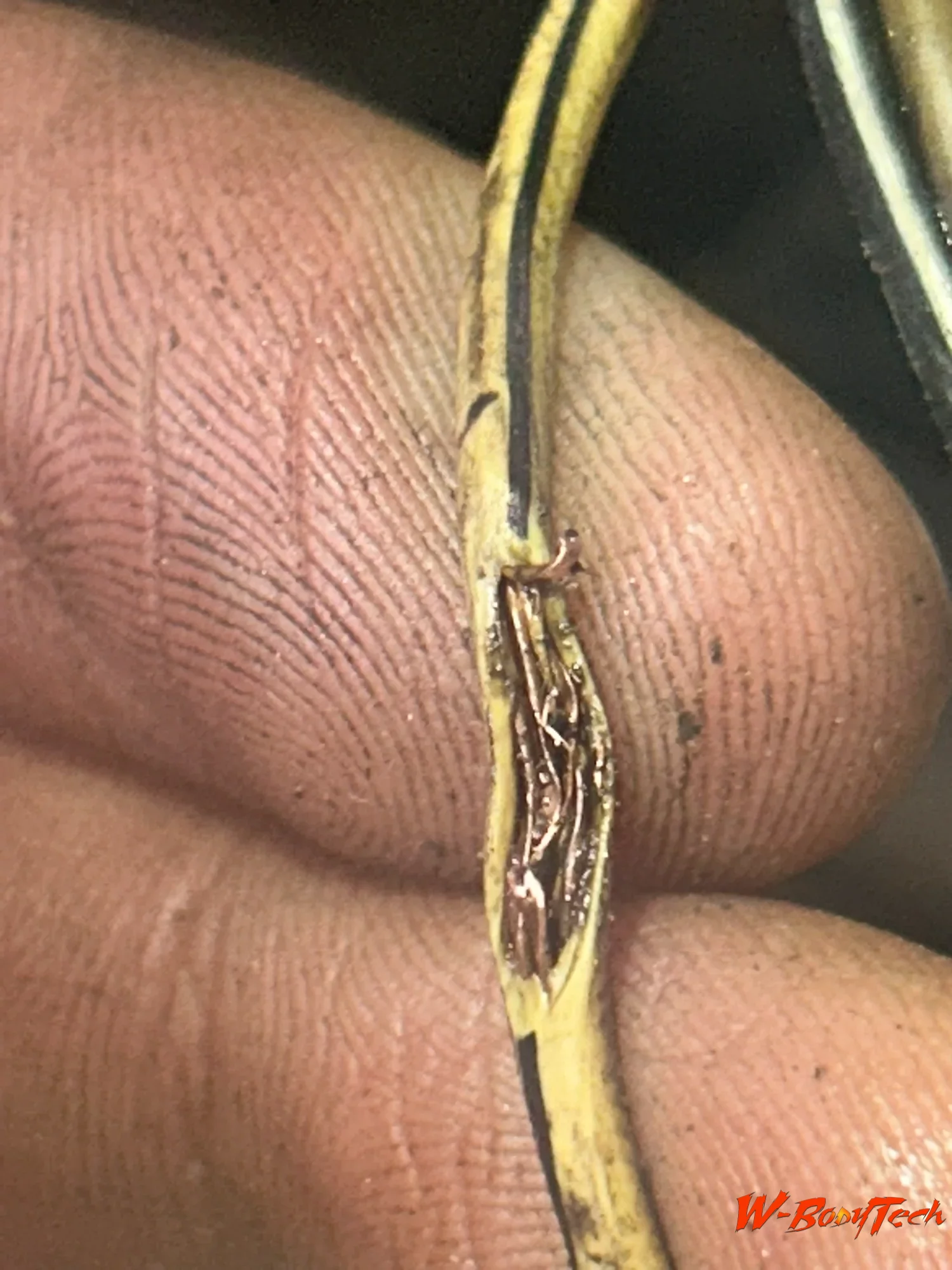

In much MUCH better news, the car runs like a top! The issue ended up being the ICM harness getting chewed through due to being incorrectly routed in a way that let the balancer rub through it. As always, huge shoutout to Rob for identifying the issue right from the start.

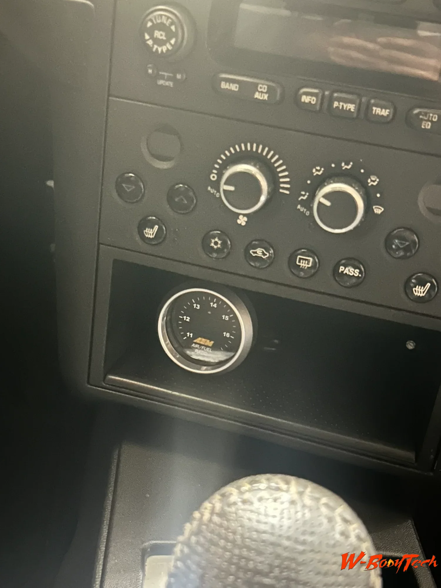

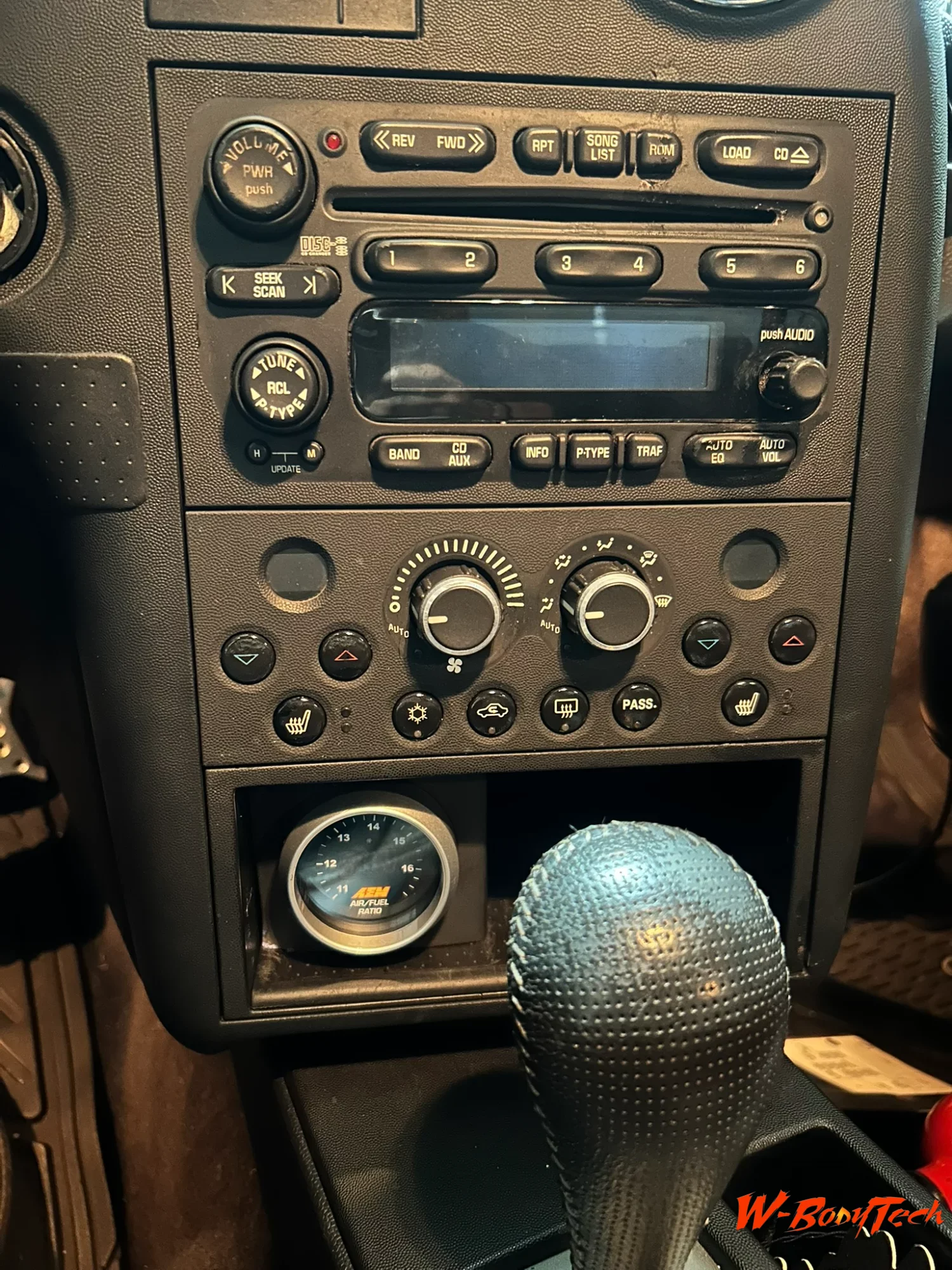

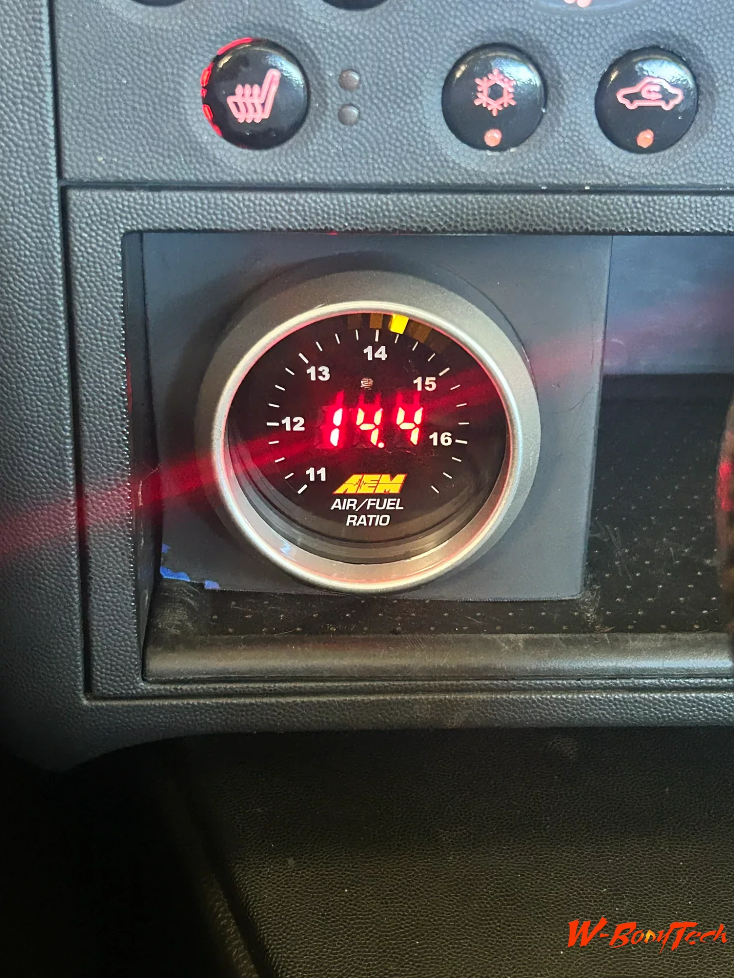

Note to everyone ever, skip out on using AEM's included wideband sensor. First one was dead on arrival, replacement one FROM AEM THEMSELVES also dead on arrival. Googlefu revealed that AEM is known for shipping out DoA sensors. Thanks to a tip from a local Wbody enthusiast I learned that most Ford ecoboosts use the same sensor, which sent me off to the parts store to find a matching connector. The cheapest one that ended up working was the $80 unit from Autozone. (Bosch 17232 for anyone who finds themselves where I am). AEM sells just the gauge, which is PHENOMENAL, so go with that and a parts store sensor you warranty once it dies.
With that all sorted, I also made myself a little mount for my AFR gauge, cost me nothing and I think it looks neat.

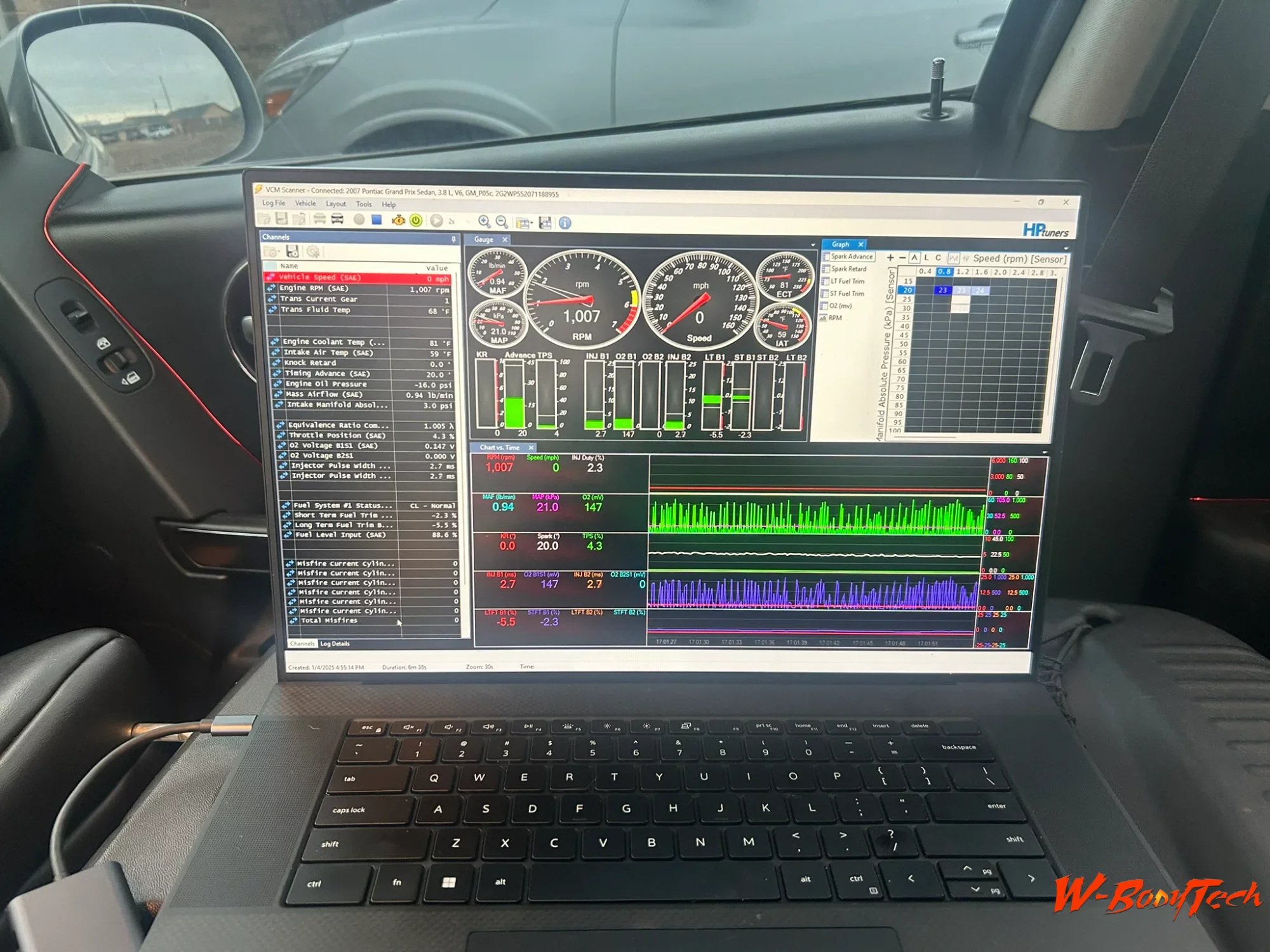

There's been this slight lean condition and weaker brakes that I've been scratching my head at until today. I originally pinpointed the weak brakes to just being old and rusted from sitting for as long as this car did, and the lean condition to being an unidentifiable exhaust leak.
In hindsight, I probably should've connected the two way earlier, but it finally hit me while making a short drive. Everytime I got on the brakes I would see the lean condition worsen, so to test this hypothesis of mine I threw her in park and started pumping the braked, and to my surprise, the LTFT spiked up to 16.4.
Boom! now both of my issues now have one easy to solve solution!
