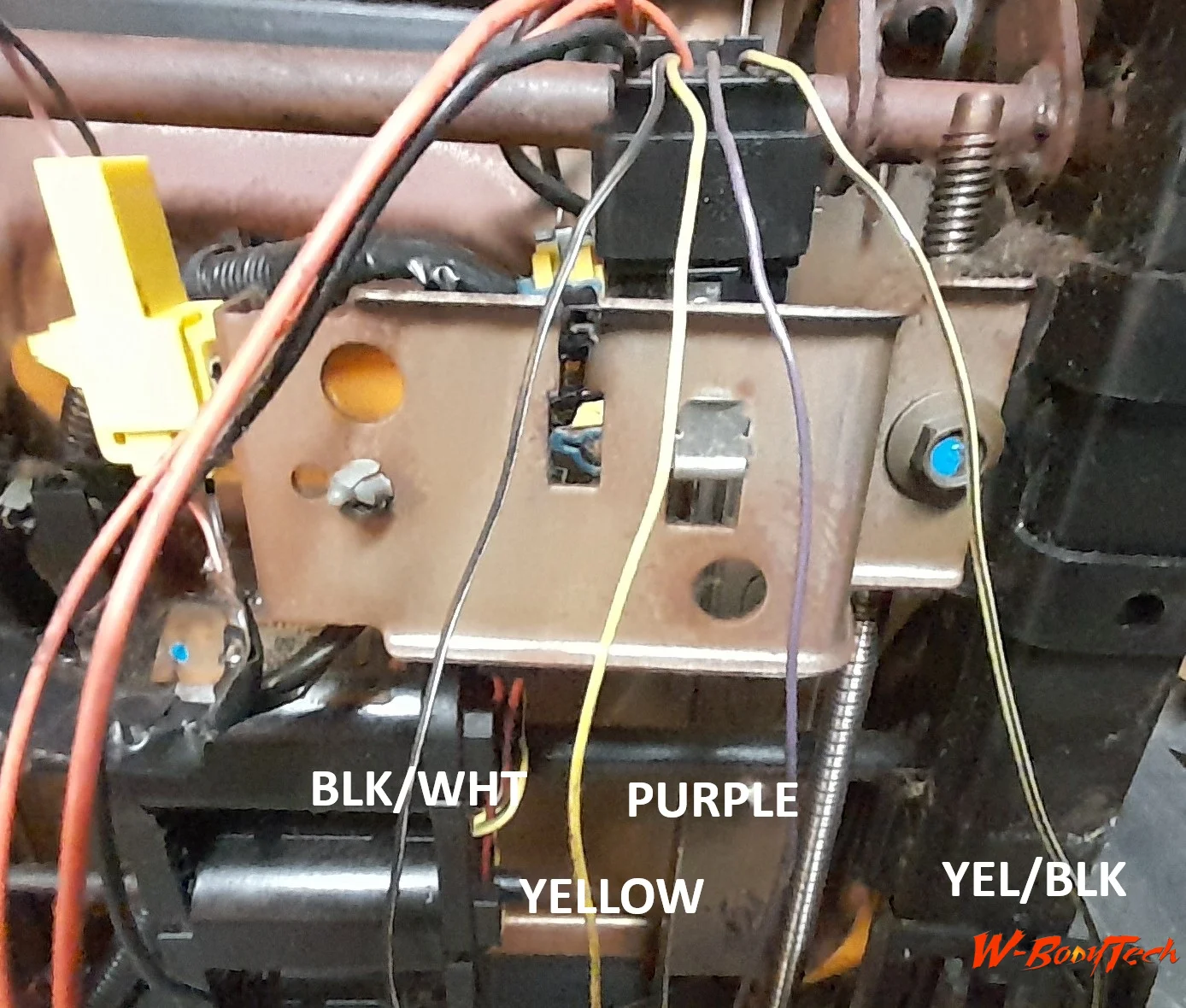

Step 1: Identifying the Wires
04+ Grand Prix Seat Wiring Colors:
- **Red/White** – Main power (12V+)- **Black** – Ground
- **Orange** – Heated seat power
- **Blue/White** – Heated seat switch signal
- **Yellow** – Seatbelt sensor (optional)
- **Gray/Black** – Airbag (DO NOT CONNECT)
97-03 Grand Prix Seat Wiring Colors:
- **Orange** – Main power (12V+)- **Black** – Ground
