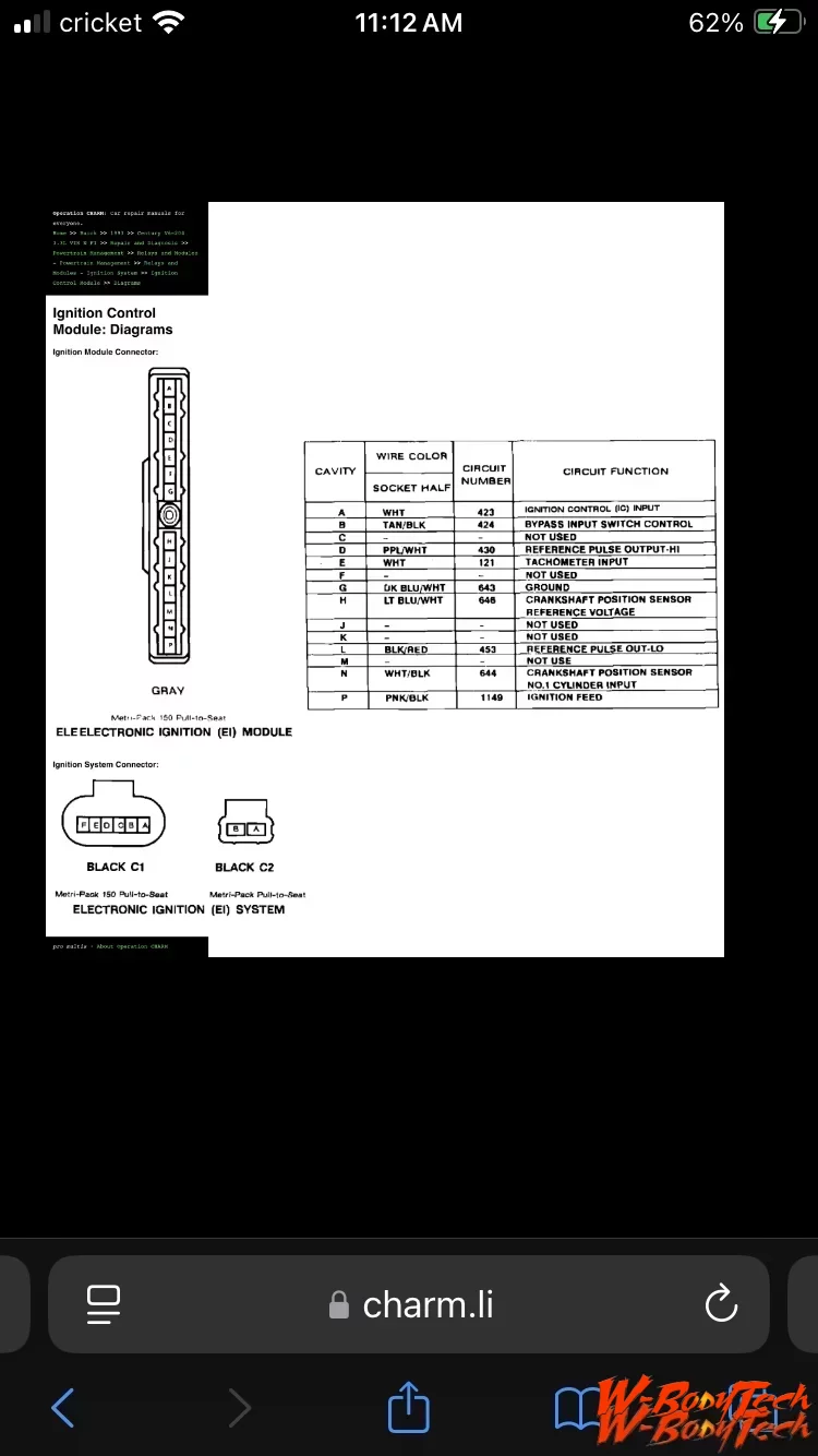

Trying to install a aftermarket tachometer on a 93 Buick century 3.3l v6 and don’t really know what I’m doing and want to do it correctly
I don’t have a stock tachometer but I do have the wire on my ICM i was told to use pin (N) and another said pin (E) which do I use
