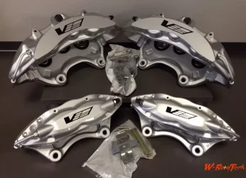

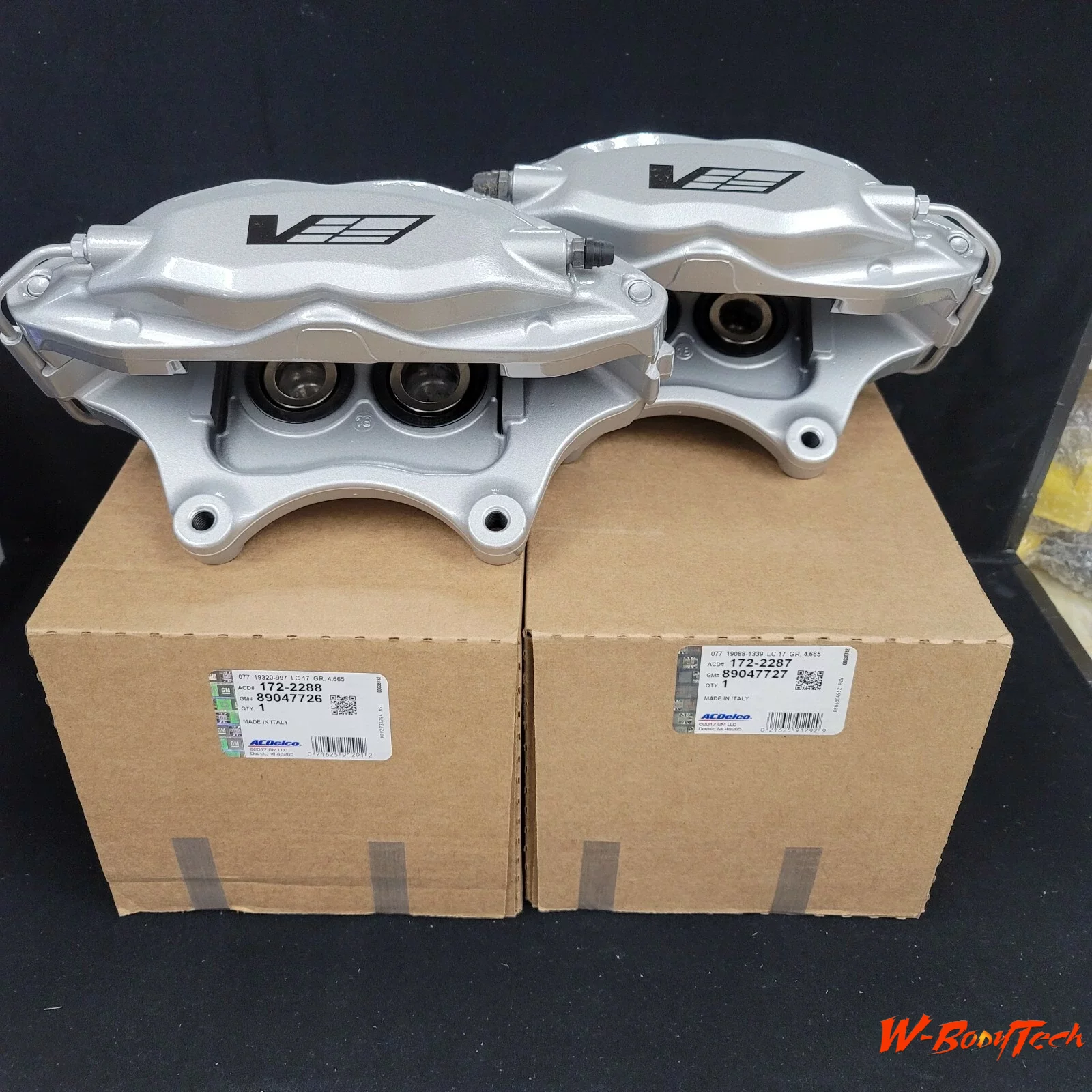

CTS-V 4-Piston Brembos

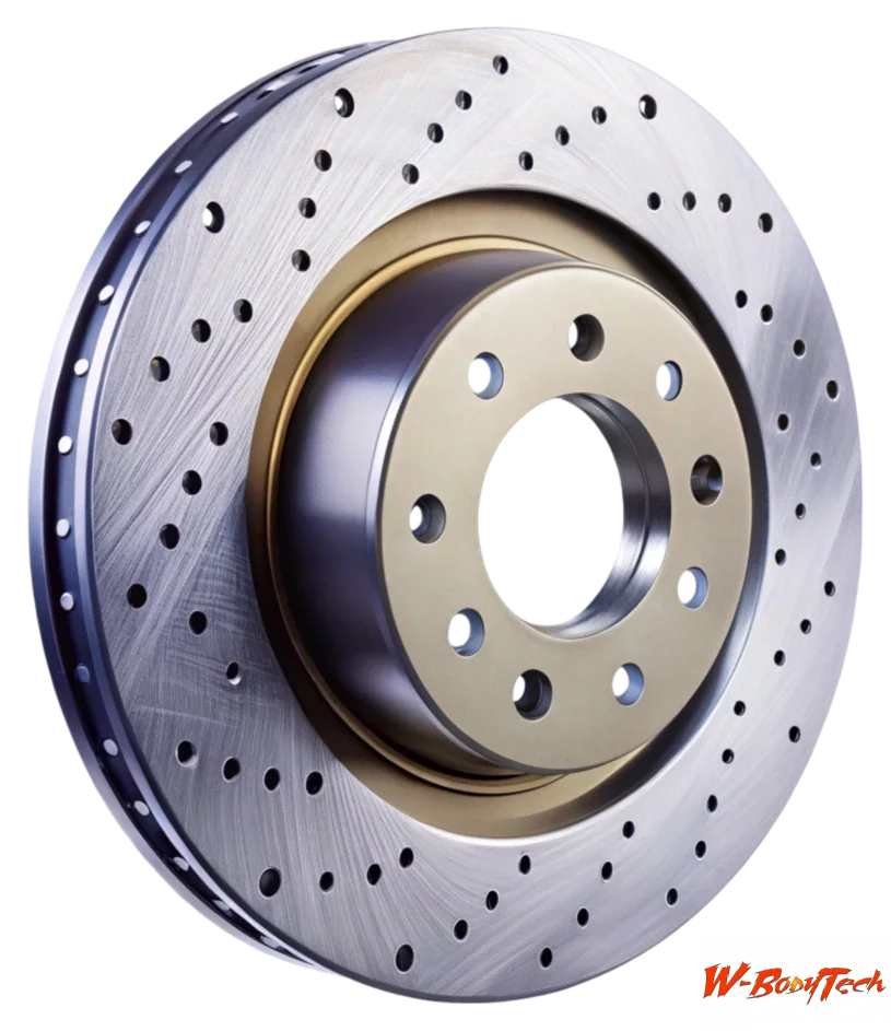

355 mm Mustang Rotor

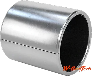

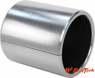

12 → 14 mm Mounting Sleeve

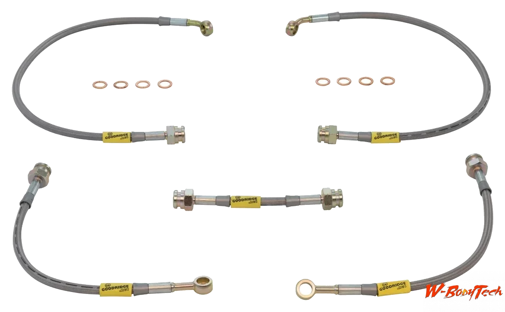

Extended Front Brake Hoses

Left CTS-V CaliperGM 89047727
Right CTS-V CaliperGM 89047726

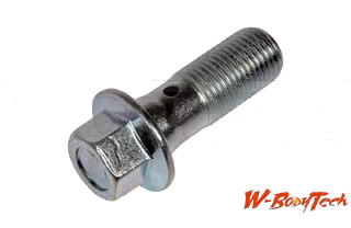

Banjo BoltDorman 14100 • M10 × 1.0

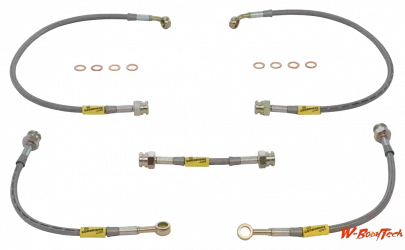

Front HosesGoodridge Longer W-Body fronts • approx. 20.5"

This guide will walk you through upgrading your vehicle's braking system using CTS-V calipers. It provides the necessary parts, tools, and step-by-step instructions for the installation.
Parts Needed​
- CTS-V Front Calipers (complete with pins and brake pad brackets). Alternatives: G8 GXP calipers or 2010 Camaro SS calipers.
- Banjo Bolt (F-body or CTS-V type).
- CTS-V Caliper Bolts.
- Extended Stainless Steel Brake Lines (recommended: ZZP Extended SS Lines).
- CTS-V Brake Pads.
- 2005 Mustang GT500 Rotors (Centric One-piece recommended). RockAuto Part #12061089.
- Four 12mm flat washers.
- Four 14mm bushings (McMaster-Carr Part #6679K16).

Step 7: Final Check​
1. Double-check all bolts, lines, and connections for tightness.
2. Test the brakes in a controlled environment before regular use.
This upgrade provides a significant improvement in braking performance and is a popular choice for enthusiasts.
