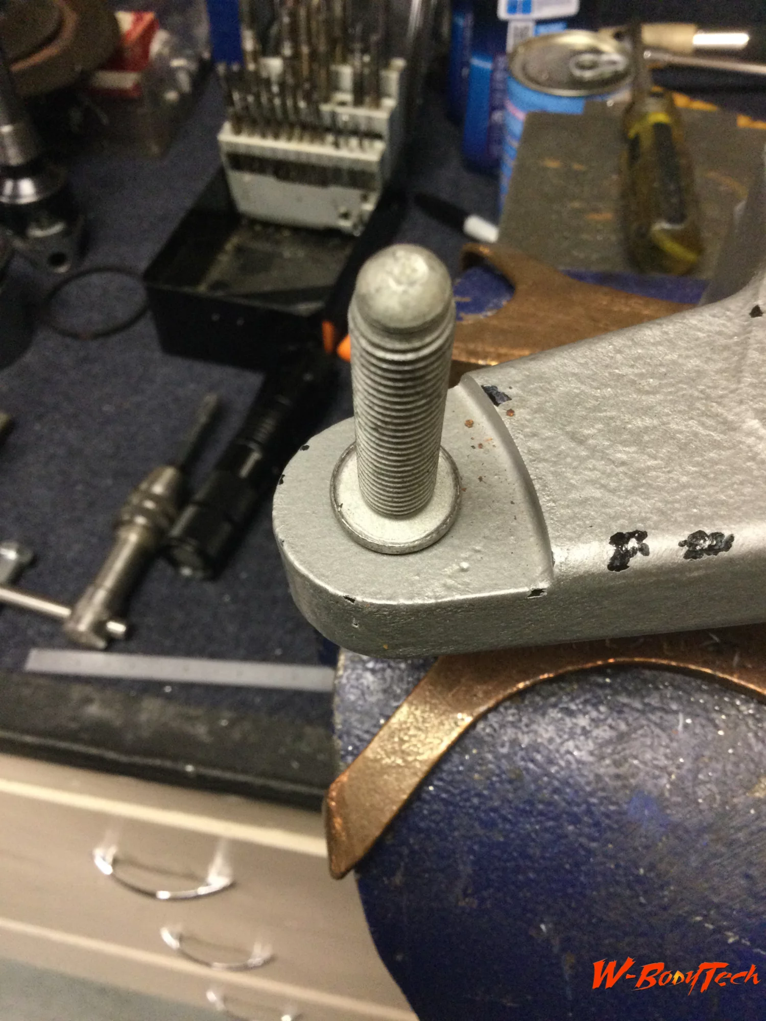

Recently I had posted on my suspension post about an issue with rear wheel hub bearings. I said I would post about the improvement upgrade as I was stepping through it. This is the beginning of that upgrade.

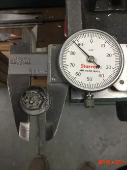

One of the other issues with the factory rear design are the bolt heads & fit. The compression part of the bolt head, the diameter, is to small & the fit of the bolt shank is far to small. The diameter of the through hole in the brake backing plate is .395 to .400, but the through hole in the hub bearing is .460! With the bolt size being 10mm (.390.), the more important fit is the bolt size to the hub bearing! So the whole setup is garbage! The clearance fit of the bolt to the hub bearing should be no more than .015 total, .0075 on a side, with .010 total or .005 on a side being ideal.

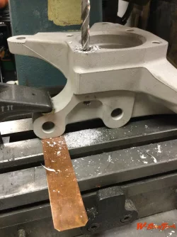

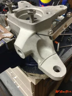

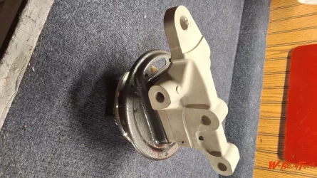

So here is the start of this improvement modification. My advice would be get a spare set of knuckles. So obviously I would recommend sandblasting or glass bead the knuckles if they’re not new.

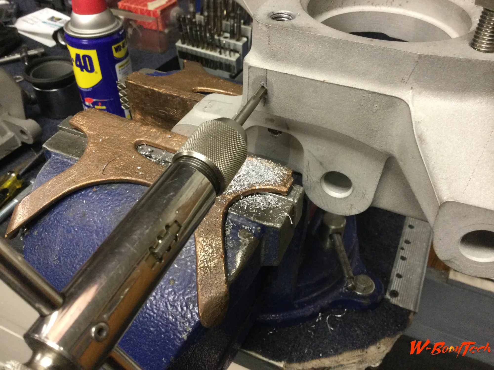

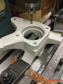

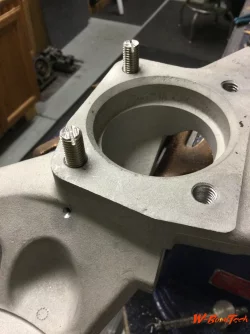

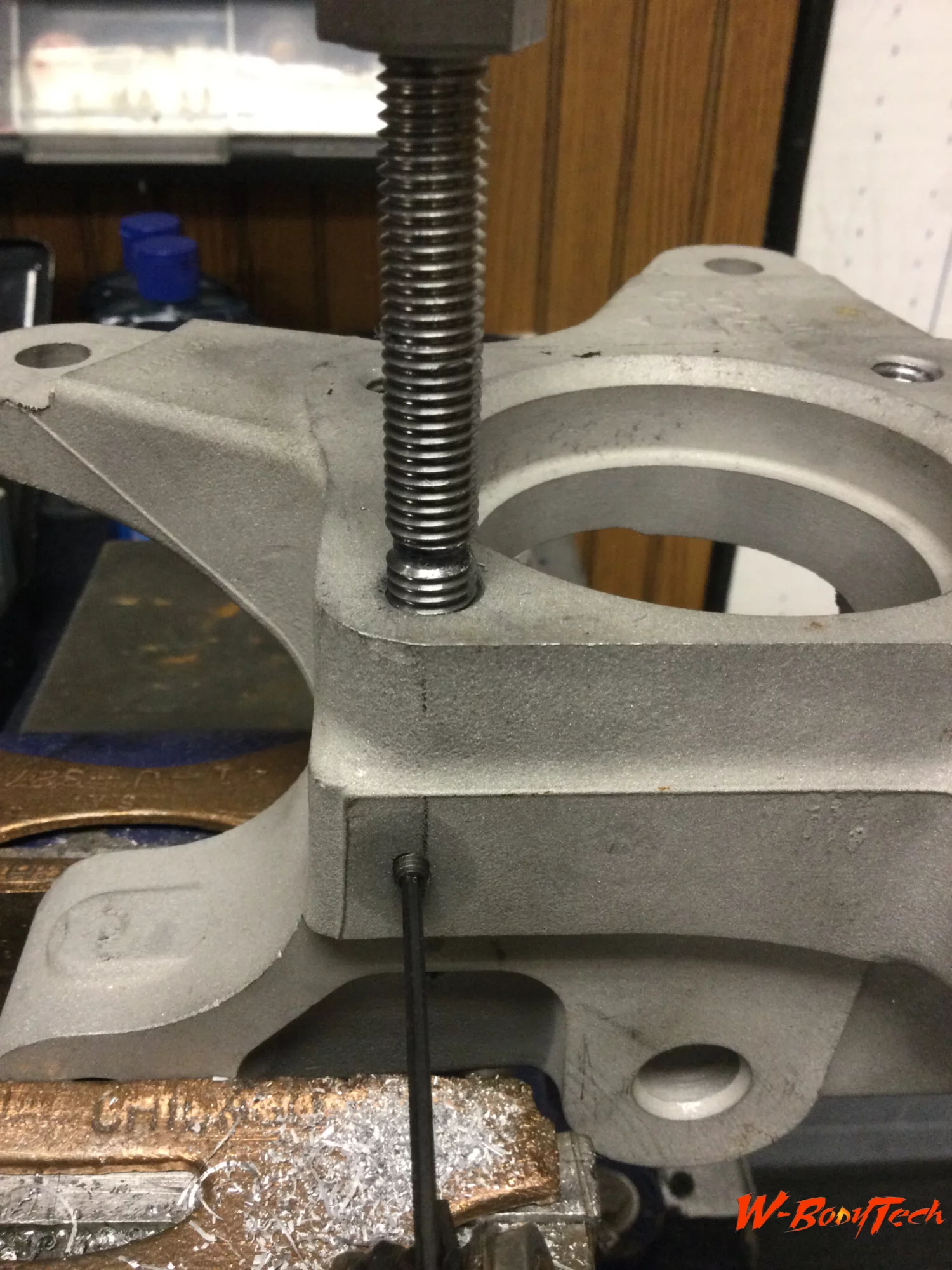

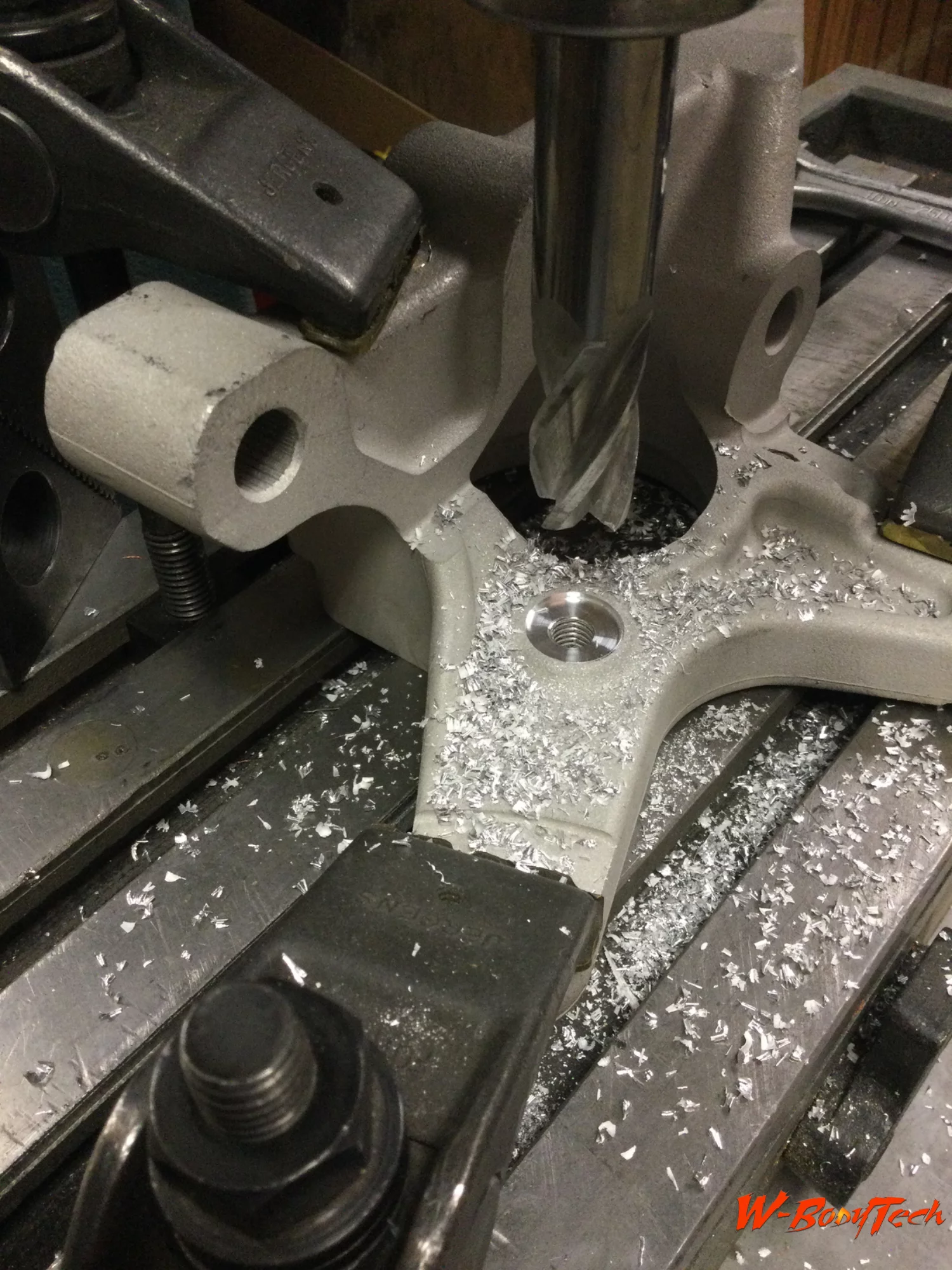

Now drill the two 10mm threaded holes that are on the opposite side from the caliper mounting flange of the knuckle deeper, about 2.250” deep total. These two holes are blind. The setup to do this should be done on a mill as you will see in the attached pictures.

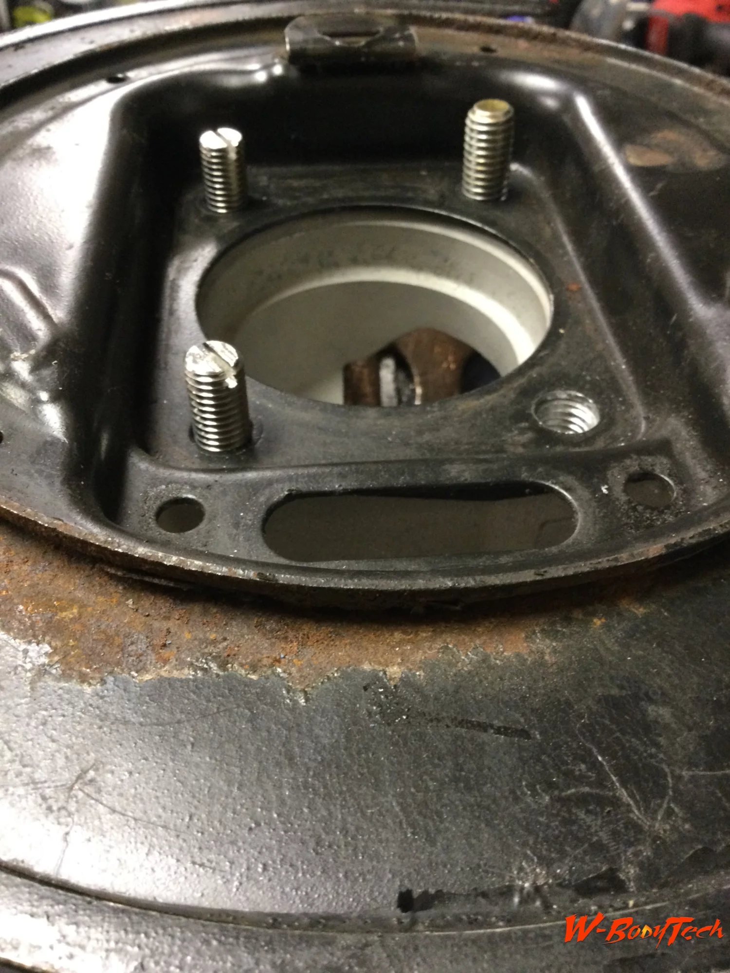

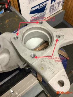

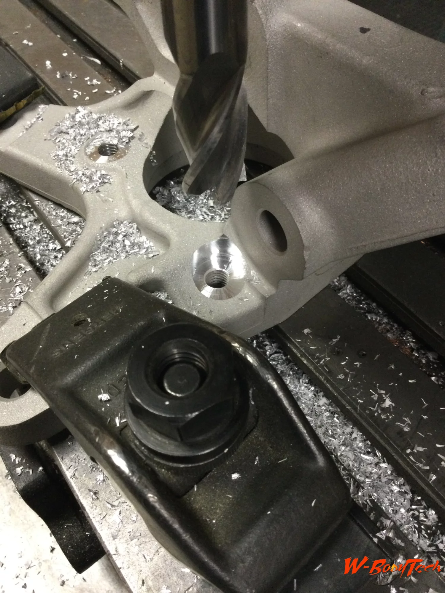

Now you will flip the knuckle over to spot face the backside of the two short 10mm through holes. This is done to make a flat surface for the new bolt arrangement that will be used. This arrangement will change the two through holes from 10mm x 1.5mm to 7/16 14 thread. This is done by drilling those two holes out to the tap drill size of a 7/16 x 14 bolt. Then tap the hole with a 7/16 tap. You will notice that drilling out the 10mm taped holes does not remove all the threads. That’s ok! Metric threads are a very different animal when compared to US threads! American threads are far & away superior to metric, fact based from the principles of what threads are! I don’t just say that because I’m American. Metic threads are weaker, strip more often & in general defy the good principles of threading, which is considered an art form! And has been from almost the beginning. I can speak to this later if someone wants to know more, but for now you’ll never know that there was ever a 10mm thread there when finished!

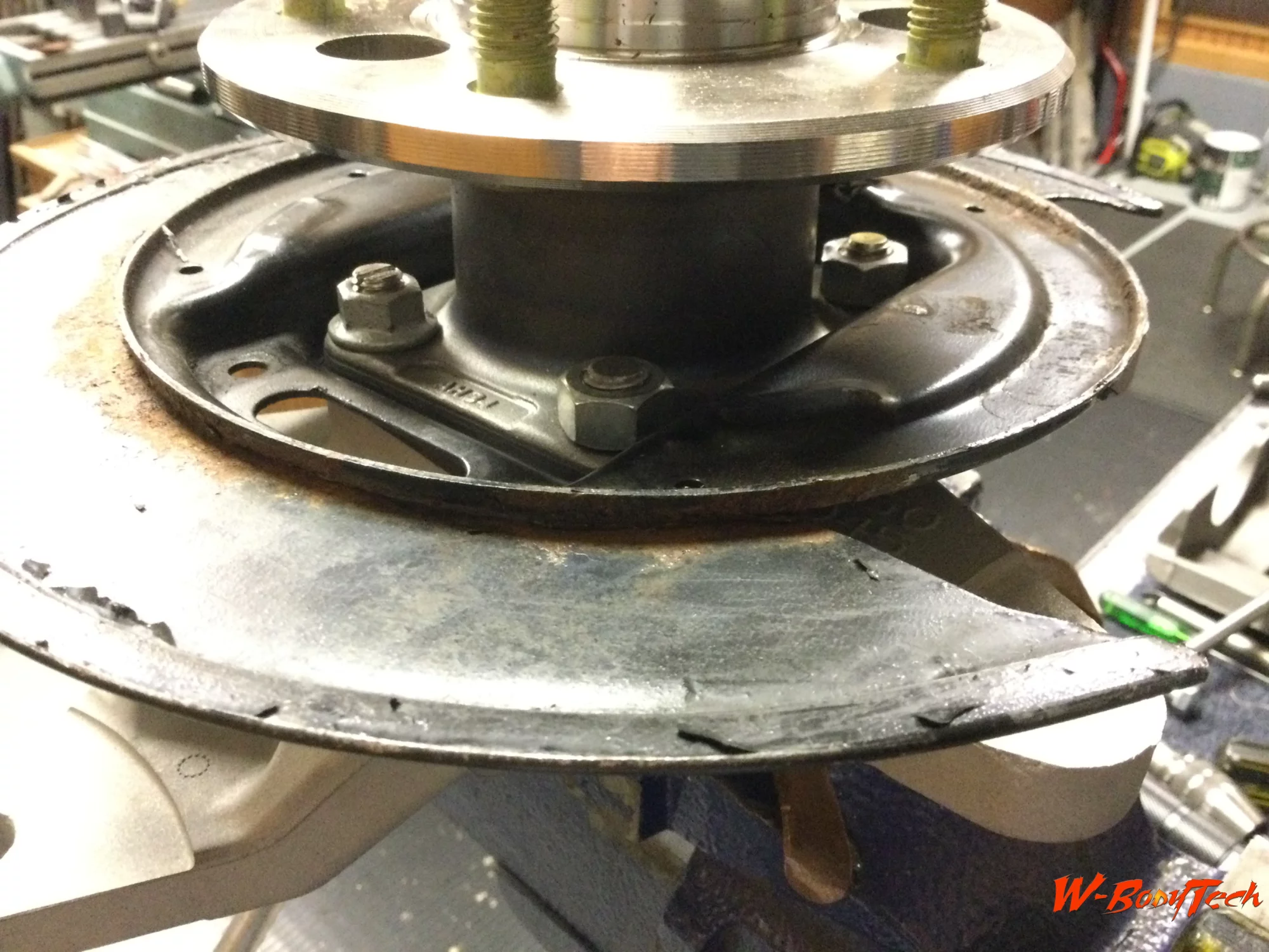

Next you will need to open up the two holes on the brake backing plate that corresponds to the 7/16 bolts. Drill them out to 7/16.

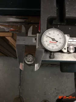

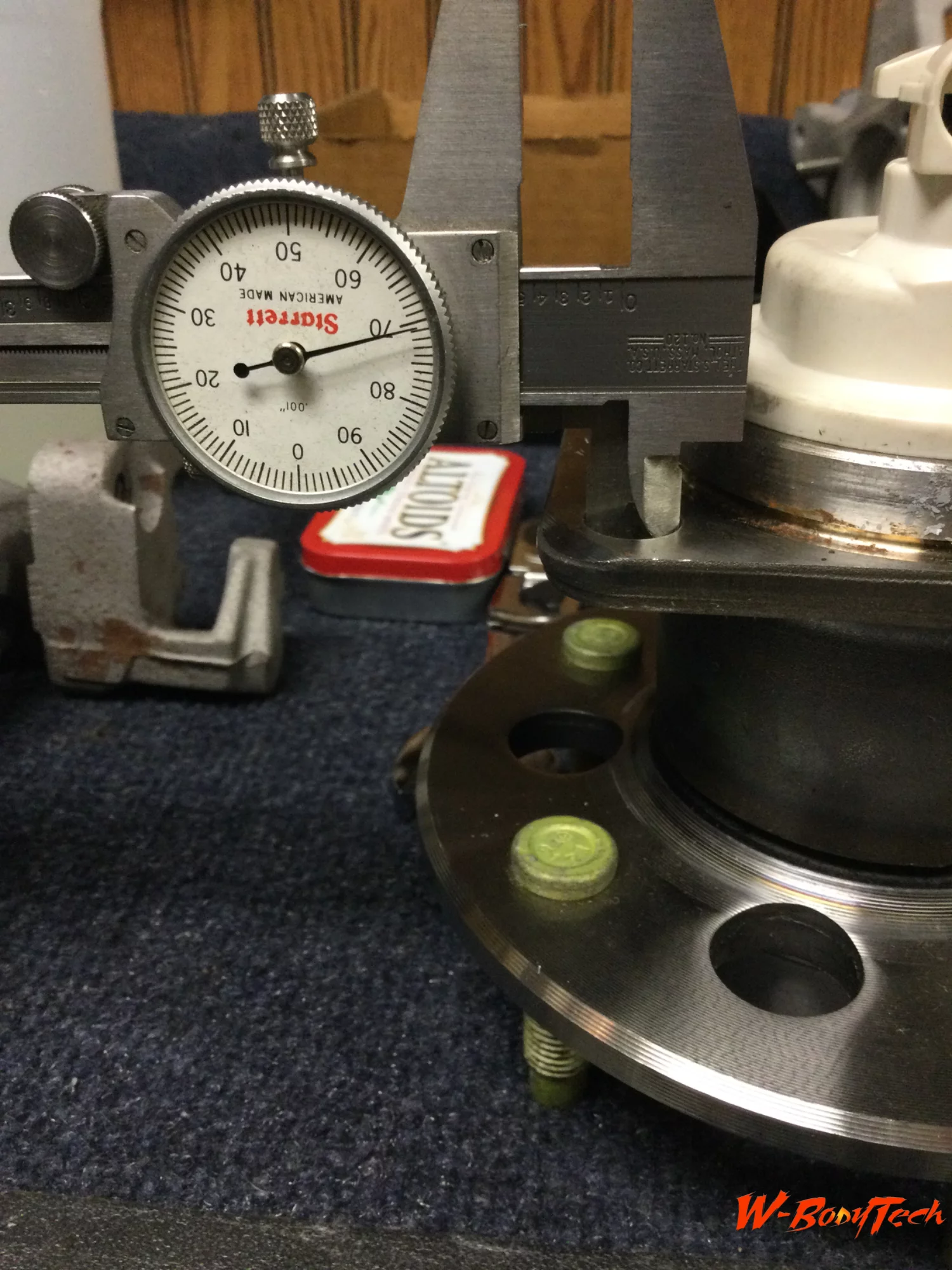

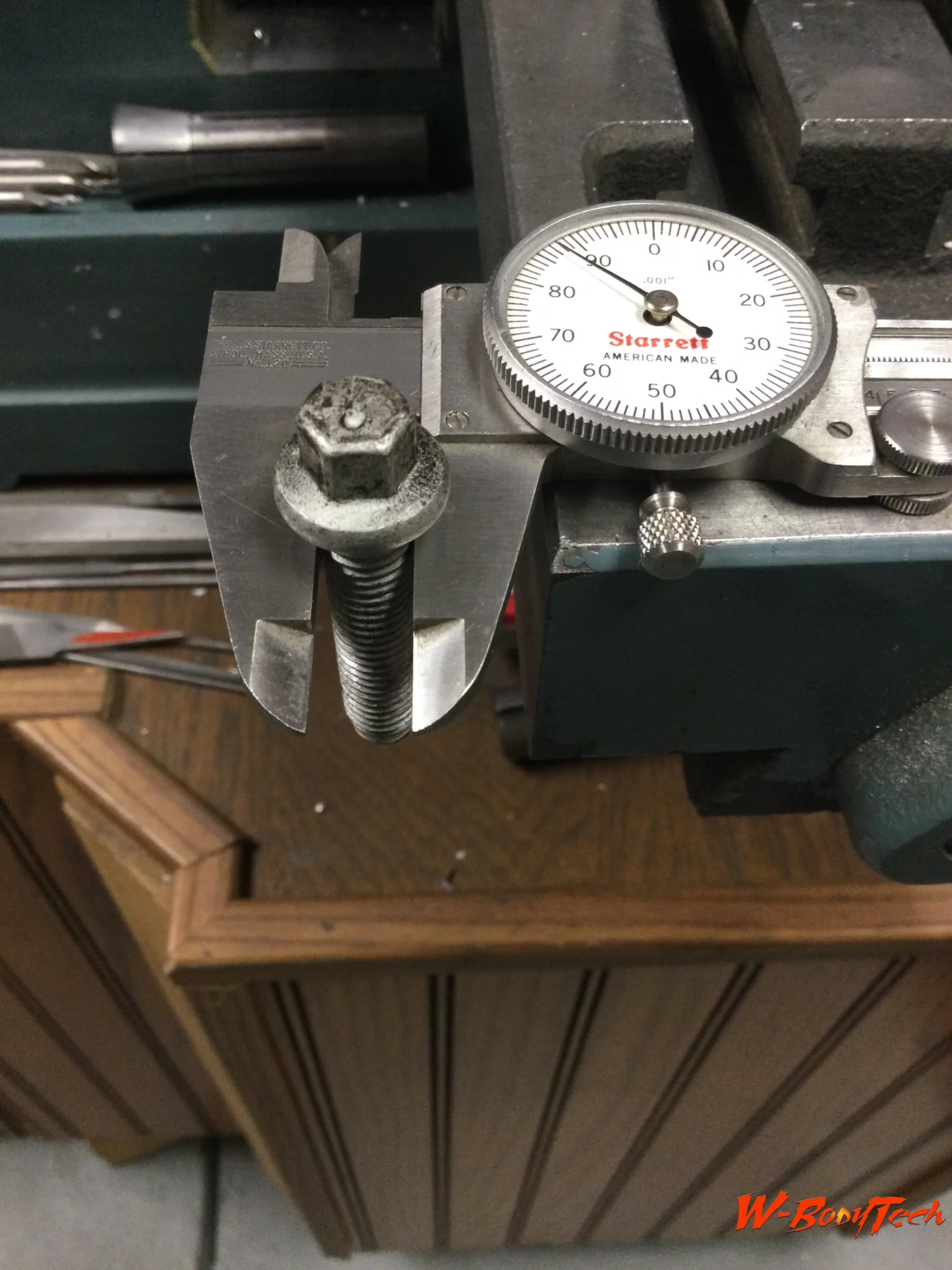

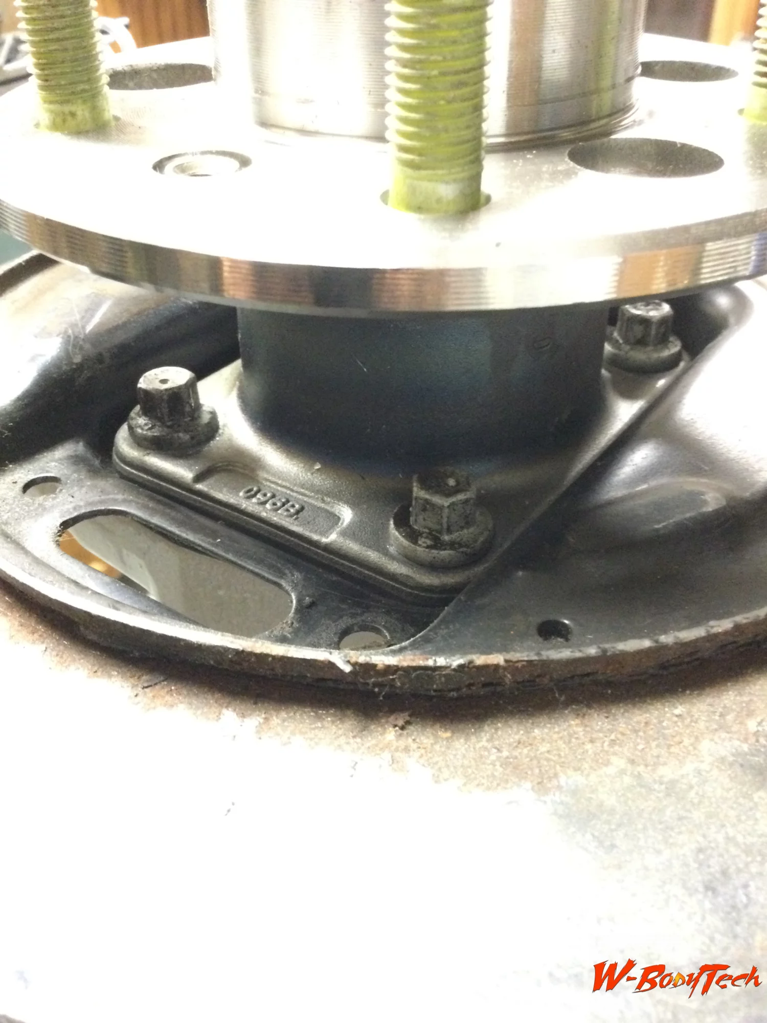

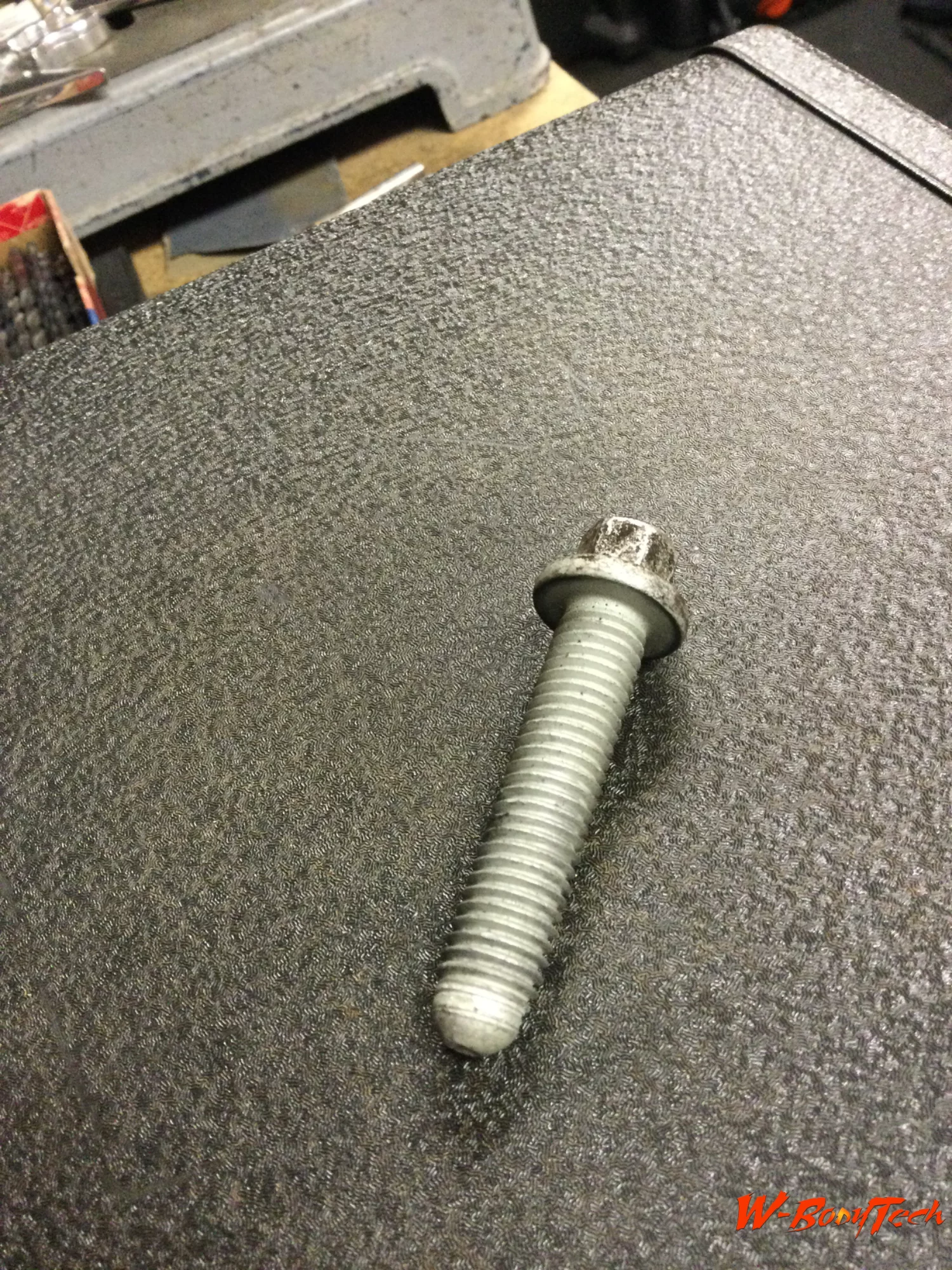

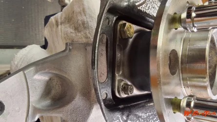

So before I move on with the detailing of the rest of this modification I want to show just how poor of an engineered setup this is! As I said before the head engineer that ok’d this design is a disgrace to the craft!
Look at the following pictures. First is the bearing hub bolt. The shoulder of the bolt head is .682 thousands by .100 thick. Yet the hole in the bearing hub is .470 thousands. Put in perspective that is only .106 thousands on a side bigger that the hole! On top of that the bolt shaft is .388 thousands in diameter. That is typical of a bolt thread as they are always a few thousands small diametrically, of which case means there is .294 total difference in diameter & .147 on a side! That is not how you engineer bolts & their respective fits. Considering the fact that these 4 bolts on each hub carry the entire transferred lateral load of the rear suspension; it isn’t surprising that under aggressive handling they fail.

One more thing with regard to the poor design. In the attached picture of the factory hub bolt, look closely & notice the thin dark circle on the outer edge! This is the only contact this bolt is making in its clamping of the hub bearing to the knuckle! That is just pitiful!

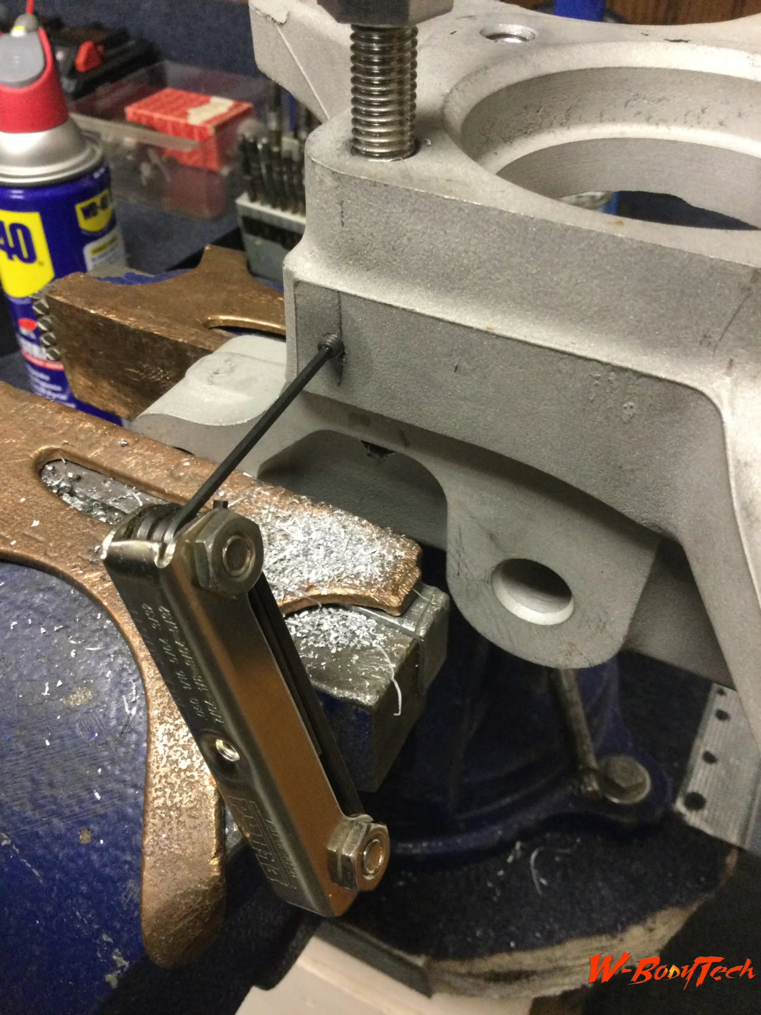

Now on with the modification that needs done for the other side of the knuckle. While the other 10mm threaded holes are now at around 2.250” deep you’ll need longer bolts. I would seriously suggest using 304 stainless steel! Why? Steel & aluminum don’t get along with each other & since these are blind holes the likely hood of there being electrolysis between them is inevitable with corrosion that will freeze them up, being that they are in a blind hole. This makes that corrosion difficult to effect because of that. So the difficulty of getting them out later maybe significant. So basically you I’ll make two long studs & set screw them. Where they interface with the set screws the threads will need to be removed by undercutting. For reference I used 8x32 thread set screws. I also cut a screwdriver slot into the top of each stud to use for installation.

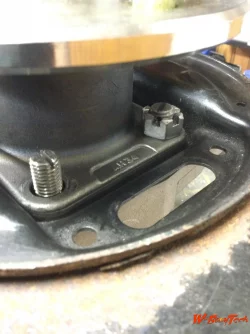

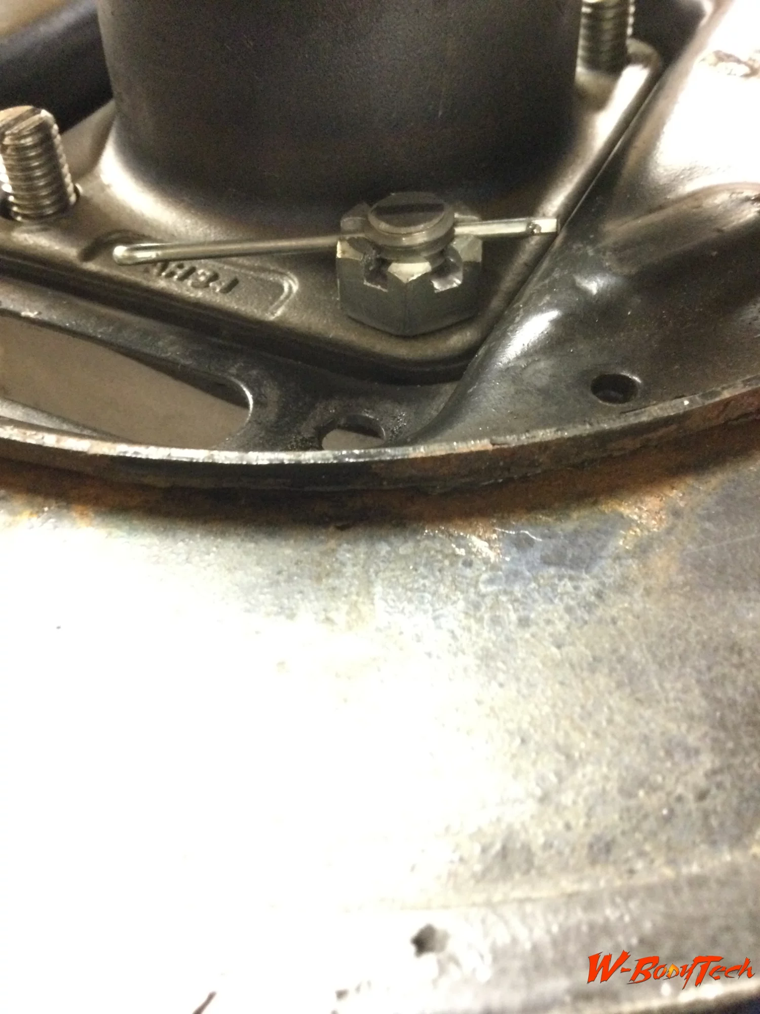

At this point the hub bearing is secured soundly. The two 7/16 bolts now only have .016 thousands clearance on a side when in the bearing hub! That’s a decent fit & will eliminate the bearings hub from any rotational movement. We also are now going to have a much larger clamping force on each hole of the bearing hub, but we are not done yet. Now comes the part that makes the complete failure of the bearing hub, I.E. wheel coming completely off the car, highly unlikely. Not to mention a much stronger more solid & robust setup that will now, like many other components that have been modified on the Indian, to reduce or eliminate flex, & subtle vibrations that keeps the suspension from transferring all the energy you can to where it belongs, the ground!
All 4 bolts are locked in place in the knuckle. The two 7/16 bolts have lock washers & are torqued to 60 ft lb. in the knuckle, more than what the factory specs call for. The two 10mm studs are locked in place by the 8-32 set screws. And now we are going to machine castle nuts for each bolt & drill each bolt for a cotter pin. This arrangement is as close as can be to a spindle arrangement from a safety & secure perspective. This is now a solid racing setup for hard aggressive cornering!

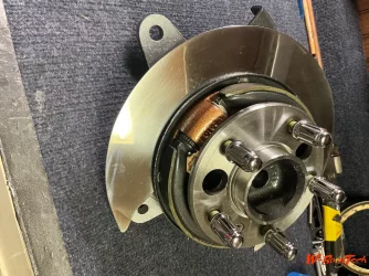

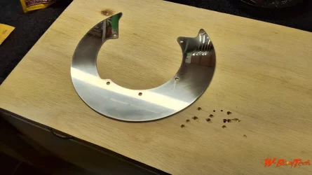

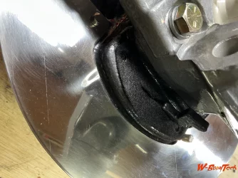

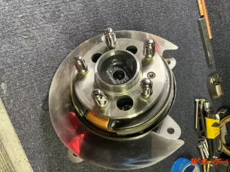

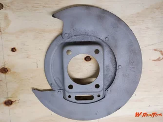

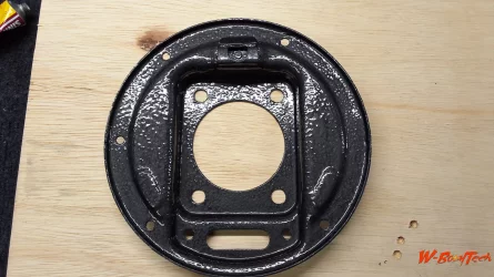

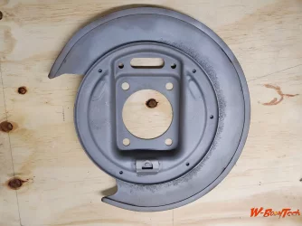

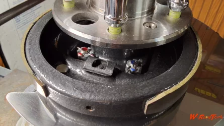

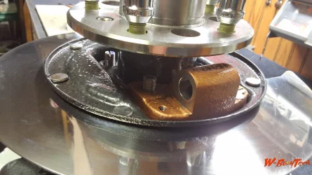

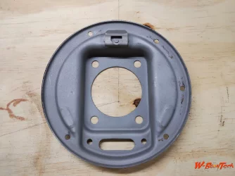

It’s been a while, but life often gets in the way! So I want to finish the rear wheel hub upgrade assemblies as complete drop in replacement as I have all the pieces parts. The backing plates are used units & as such need to be cleaned up & as a result of that once again I see an opportunity to increase their quality, durability & appearance. They consist of a two piece assembly. The main hub plate that helps house the wheel hub bearing & is the main structure for the parking brake. Then the other is an outer dust/deflector plate for the disk brake rotor. These two plates attach in a preformed rivet manner which works well for manufacturing & function, but not so much so for durability & duration, just makes a trap for debris that causes corrosion. I will separate the two & use only the main hub piece while replacing the outer dust/deflector piece with a fabricated 316 stainless steel piece. This will not only be more durable, but look better while resisting corrosion between the two plates.

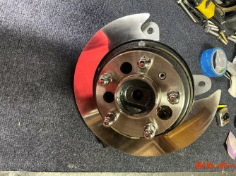

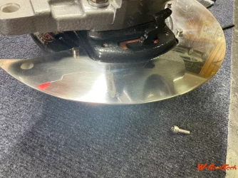

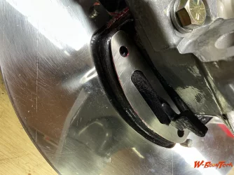

Getting back to rear knuckles/bearing hubs. As mentioned redoing the rear hub plates that attach to the knuckles & encapsulates the hub bearing & houses the parking brake. The outer shield that protects the rear disc has been removed & replaced with a custom stainless steel plate.

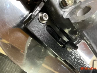

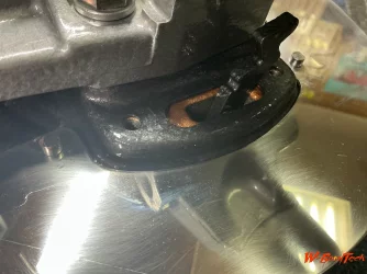

So I have just about finish all the mods on one side, including making a reasonable sealing setup for the parking brake, since there is no replacement for the OEM boot design. Now I need to disassembly the whole assembly. Go through it, lube the parking brake wheel cylinder, double check everything, reassemble torque all the bolts, install all cotter pins, etc, etc..

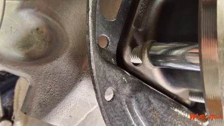

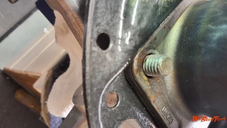

That said notice in the pictures the excess clearance between the original bolts & the clearance holes as well as the minimal amount of material of the bolt head that actually holds the wheel bearing in place. This is a huge design error for any aggressive handling!
