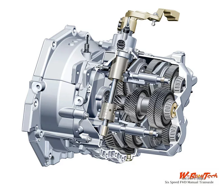

Pontiac G6 GTP F40 Manual Swap: Parts Guide
6 Speed Saab MR6/F40 Pontiac G6 GTP F40 Manual Swap: Parts Guide

1. Drivetrain & Axles​
The F40 6-speed is a high-torque unit. It requires a specific manual-only "jackshaft" and matching axles.
