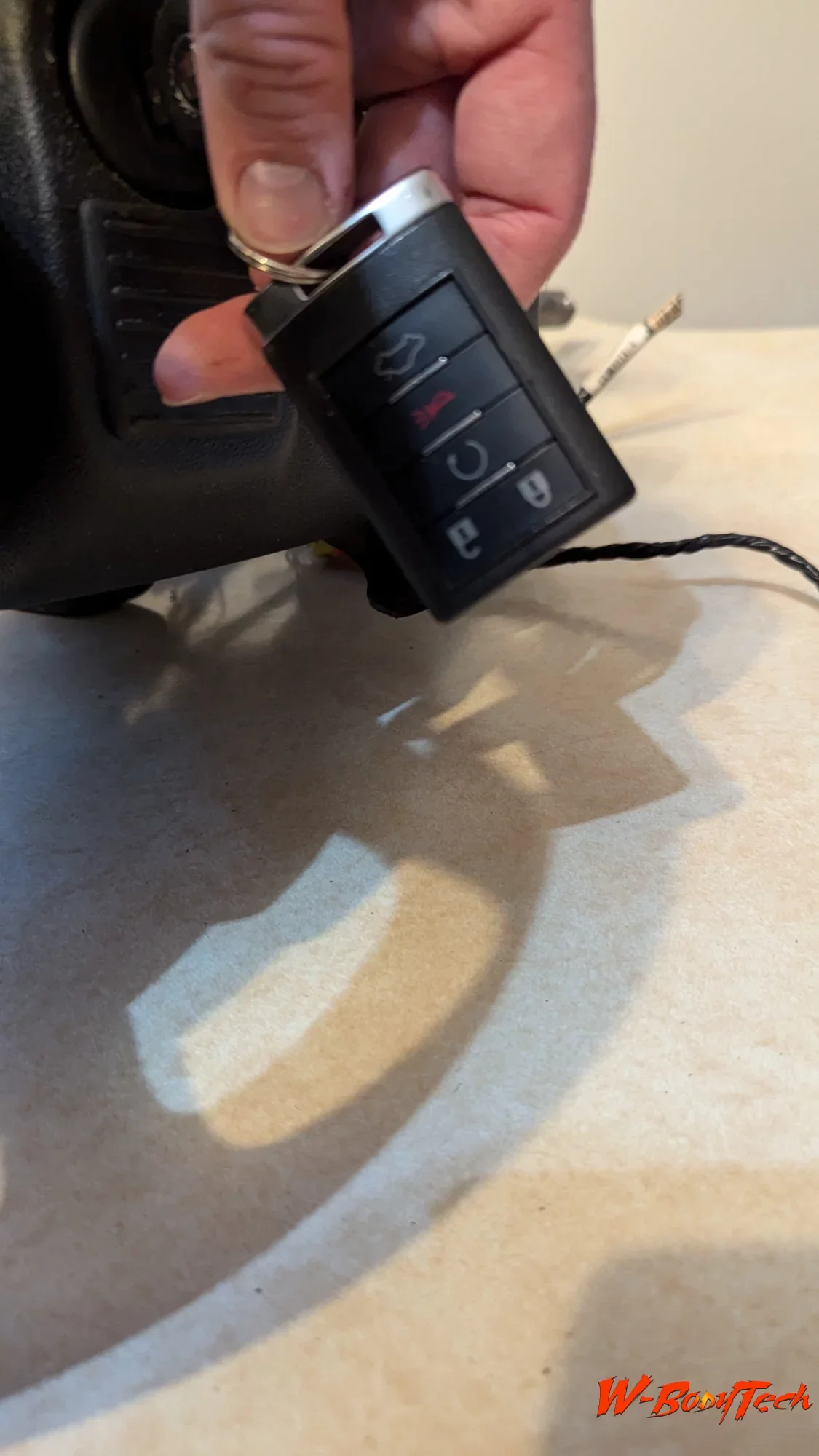

The 9th Gen Impala has a keyfob that's shared with virtually every GM vehicle from the same era (2006-2013) If you look at the back of your stock fob, you'll see the FCC ID of OUC60370. Not only does your "Fisher Price" fob have that ID, but so does the fob of several "cooler" models. One such vehicle is the Cadillac DTS. Yes, that's right, you can program a Cadillac DTS fob to your Impala!!

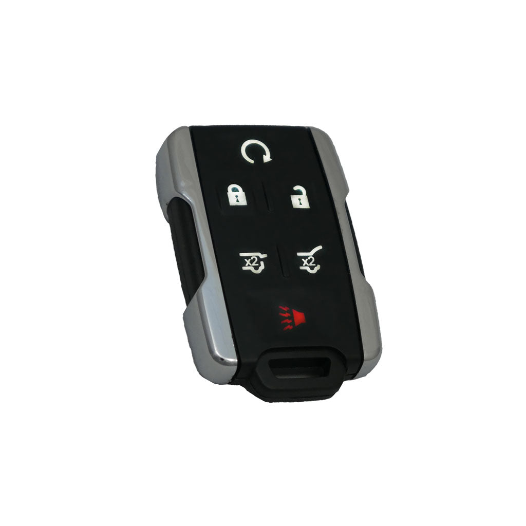

Boost Auto also sells fobs for the 07-14 Tahoe/Suburban/Yukon that resemble the fobs of the 2015 Tahoe and 2020 Acadia. The 07-14 SUVs also use the OUC60270 fob, thus you can also program these fobs to the 9G Impala!

This is very cool and useful information, now that I know this I’ll be using one of these on the next project! but lmao to “fisher price” key fob 🤣
