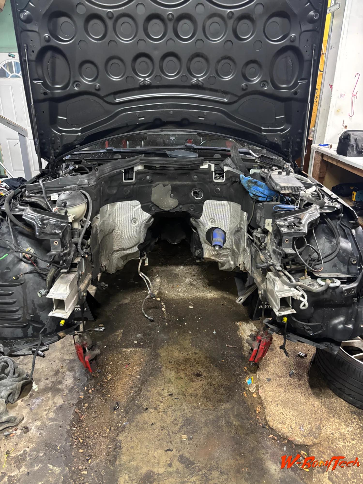

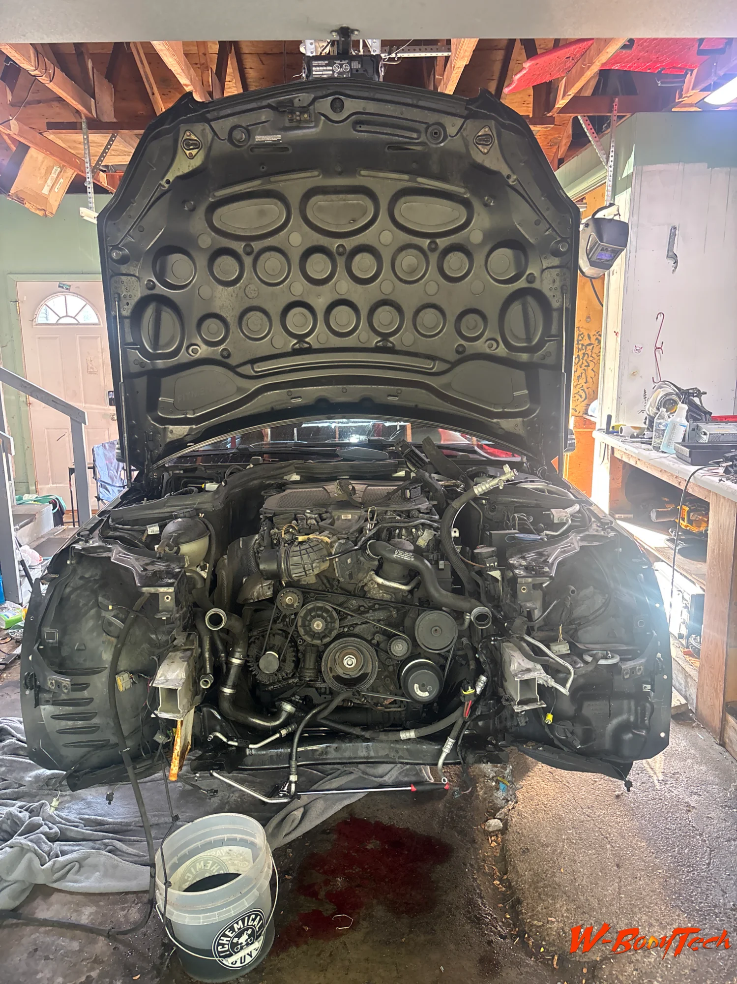

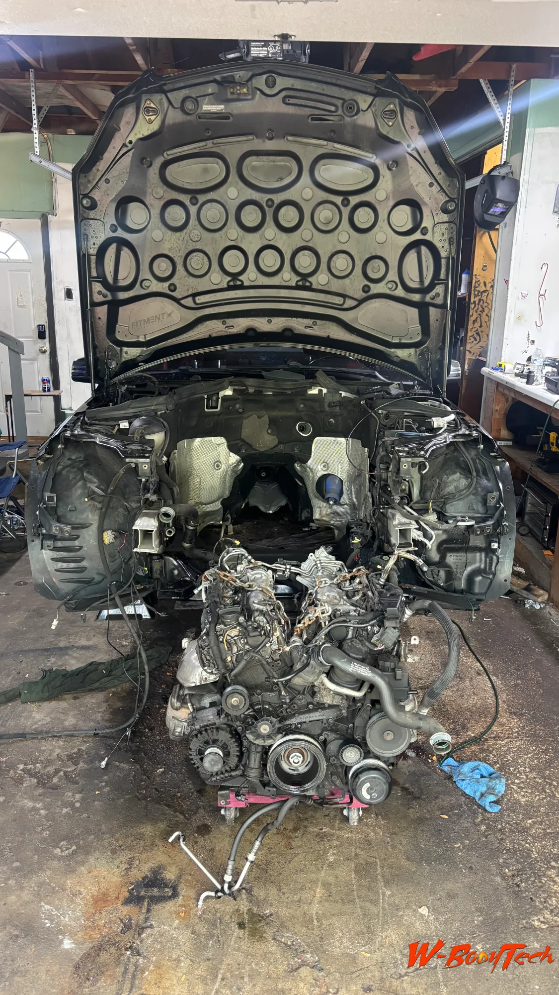

Hello everyone! Bad news, but its going to turn into good news!
Unfortunately, due to sloppy work from the mechanic who worked on this car before I owned it, the engine blew up. WAYYY too much RTV was used on the timing covers, and it eventually broke off and clogged the oil pickup, starving the engine of oil. BUT, this gives me the perfect opportunity to turn this into a full time project since I have another daily to use! The car is rust free, has a nice and rare interior package, and already looks great from the previous mods I've done.

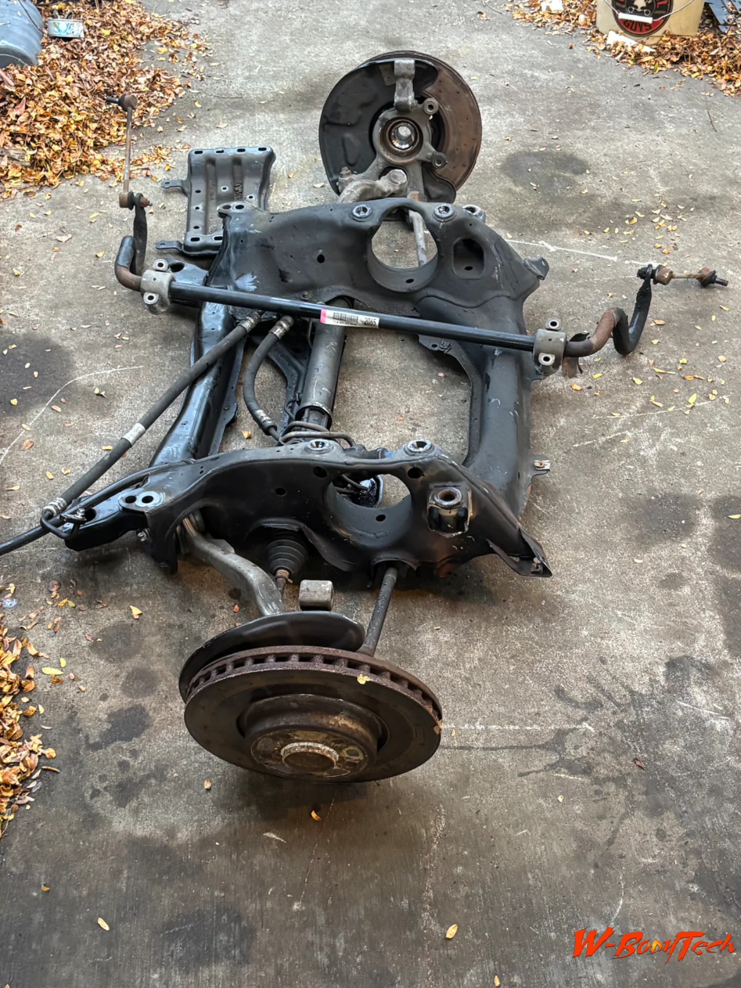

I already pulled the original engine and transmission, and today I got the AWD specific front subframe and suspension out.
The plan is to convert it to RWD and swap in an engine that will give it the performance and handling to match the looks! I already have an engine in mind, but im keeping it a secret until I get it :)
Heres some pics of everything pulled out.
Hope you guys like the update, and stay tuned for more!
